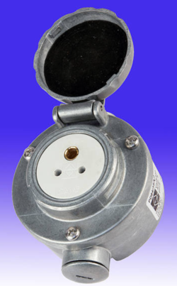

We wanted to hang festoon lights in the garden and have them switched from inside the house and my builder (4 years ago) installed a '10A 3 Pin Weathertight Socket'* on the exterior wall of our house.
Now we are (finally) trying to get the lights and all the festoon lights I can find have 'normal' UK (interior) plugs on them.

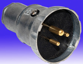

I thought I could cut the 'normal' plug off and attach a plug for the '10A 3 Pin Weathertight Socket' but the only plug I can find to fit** does not seem to be designed to work with a 'normal' cable*** - like the one on the lights.
Is there some kind of plug I can get to fit the socket (and cut the normal/interior plug off the lights)?

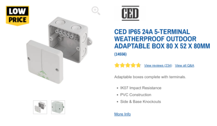

If this is off a normal light switch inside, off the lighting circuit… and the festoon lights will not be required to be unplugged at any time, then the plug/socket combo could be replaced with a joint box.

Can you please tell me what you mean by a joint box.
Something like this picture?
Thanks again.

Nothing too industrial.
Something like this would do. With the appropriate glands fitted

Thanks - I was trying to find out the name of the bit that the cable passes through - and you have helped be out with that one too. Cheers.

If the cable is coming out through the brickwork - is there an adaptor to make sure water does not get in behind - and would you just cut a hole in the back of this box - or is there a knockout? Or are there boxes designed for this (that I don't seem to be able to find)?
Whiska box with some cable glands would be good.
Swap out that useless 10a outlet for a standard 16a blue ceeform outlet and just stick a 16a plug on the end of your festoon.
