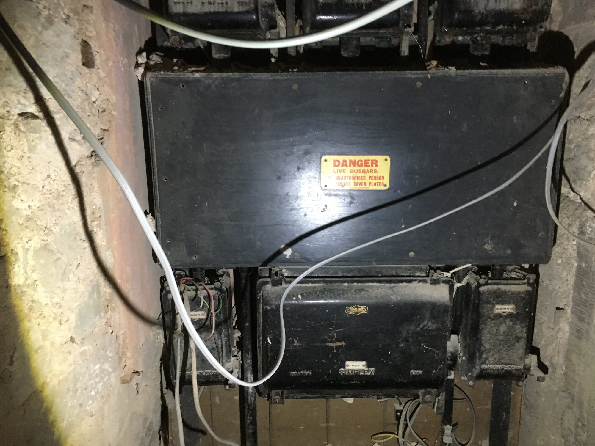

[ElectriciansForums.net] Extract fan recomendation
this my recommendation ,oops just readied it extractor fan .lol.
