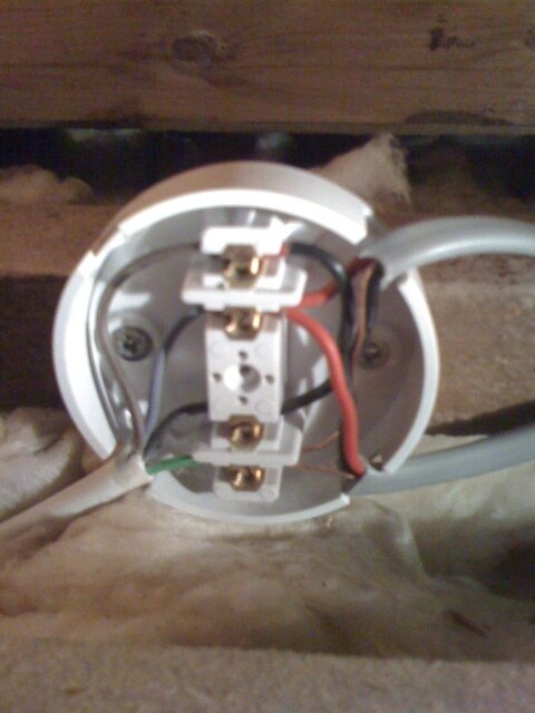

From another (non electrical) forum, someone has posted a thread about changing a knackered pull-cord switch in the bathroom that he cannot seem to get working.
As an apprentice electrician I've been trying to get my head around it and I can't quite figure it out, especially without seeing it for myself. Is there enough info here to diagnose?!

Hmmmmm my setup is seperate from the light and it did work prior to the switch breaking and having to change it. I cant work out why it no longer works and seems to be turning on when a switch for the light in the loft is turned on???
I have pics now to explain my setup better.
[ElectriciansForums.net] Extractor fan and loft switches
As you can see on pic 1 the grey cable on the right is taking power into the socket in the loft. You can also see the wires between the small gap between the socket and light switch. This is the source of power to the light switch in the loft which causes the fan to work when the pullcord downstairs is in the on position. This is the only place this light is connected to the circuit. Grey cable outta the socket takes power to the brown box and feeds into the fan circuit

This is the pullcord switch. I have wired it in every possible combo to get it to work lol. This is just how I left it last night when I got fed up messing. When in the on position the light is on so it is getting power.
Why the feck would the light switch in the loft affect this? Why wont it work? HELPPP!!!
Hard to tell, could someone,@*! of taken a live from the socket into the common of the switch, then from the other side of the switch back to the double socket the same as a switch live. Which connects to the cable going to the fan unit. This would then only allow the fan to operate if the loft light was in the on position.This is assuming the loft lighting has a neutral by either three core or they've used the cpc! I would like to look behind the double socket and the loft light switch to see how this is wired because if the loft lighting switch and light fitting are not joined to anything else then there is no way it can control the fan.

No. I'm bored of looking at it now, I can't quite tell what is going on (and I'm over-looking at the pull-switch wiring as he stipulates he's already tried each combination).
It's something to do with the neutral (assuming the black is neutral LOL) in this:
to me it seems that the new pullcord is double pole and he has the line into the feed side and the neutral (switch return) on the load side but on 2 opposite terminals which are not connected when switched so therefore the "switch return" will never get a live feed.
