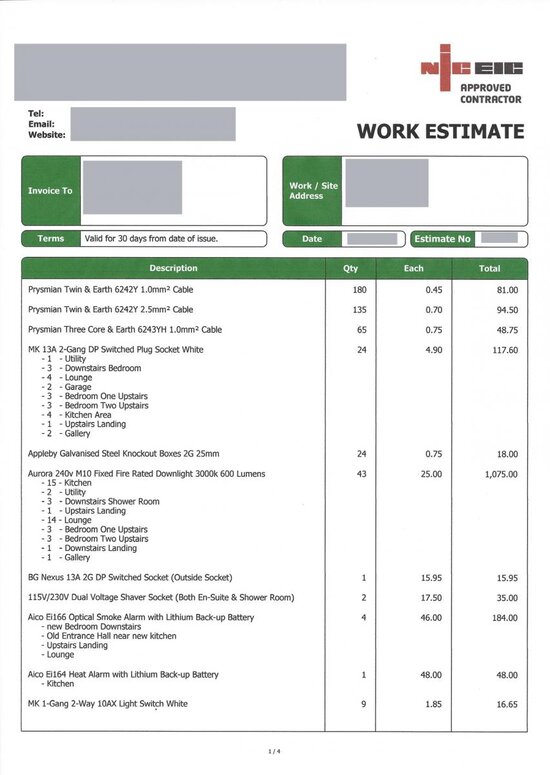

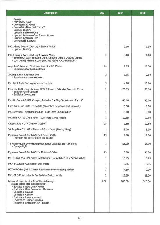

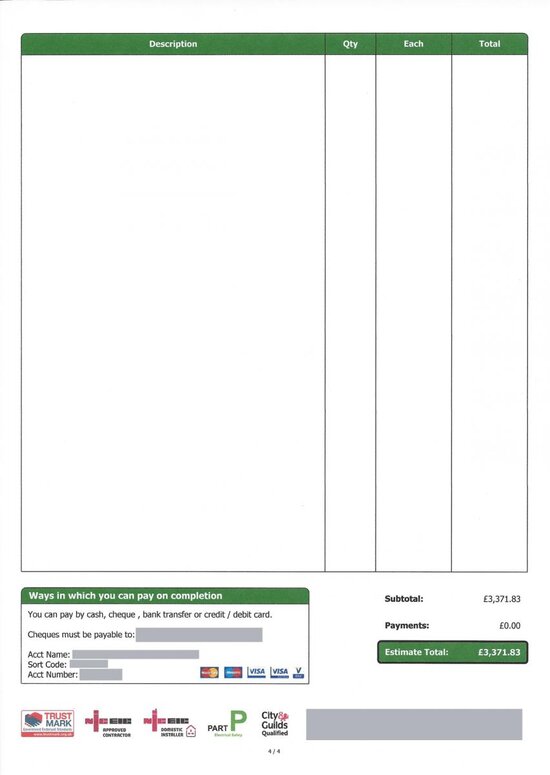

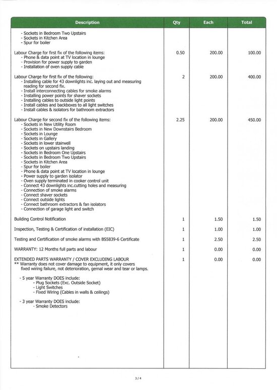

I always give a full itemised breakdown, literally every last nut and bolt, it makes me look more professional and it helps me remember what I need for the job. I'll scan one in and show you.
This is a typical quote, I personally would not expect to see anything less, I cannot stand people who do quotes and just give a figure, you should really justify how its worked out.
I often see quotes from competitors and they look like rubbish, its no wonder I win so many jobs over others round here.
This one is for a job I quote on last week, and have got it and booked in ready to start.
[ElectriciansForums.net] Fair Price for Electrical Work[ElectriciansForums.net] Fair Price for Electrical Work[ElectriciansForums.net] Fair Price for Electrical Work[ElectriciansForums.net] Fair Price for Electrical Work

How can that only take a day and a half to 2nd fix? There is at least half a day doing the mains and testing. Me and my mate can 2nd fix a 3 bed...
