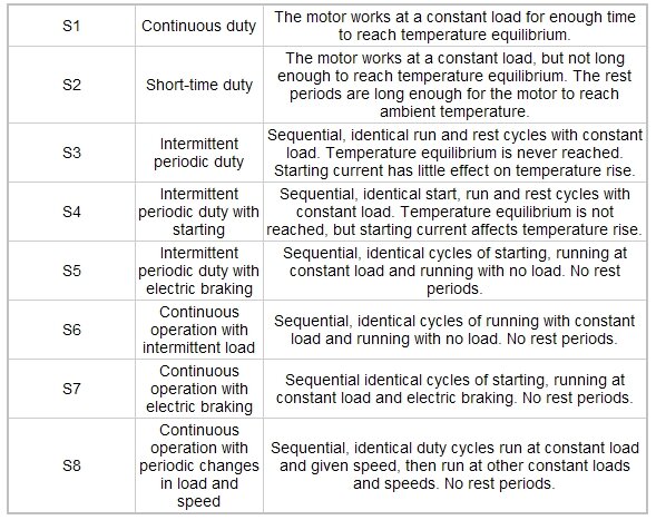

I need to fit a fan in a small utility room - which gets too warm due to a couple of fridges/freezers in there, and just a couple of air bricks for ventilation (the door needs to be kept closed). A small extractor fan should draw enough air into the room via the air bricks. The fan needs to run continuously, but also last a reasonable length of time - measured in years, not months.
Looking at product data from the likes of Manrose, Xpelair etc, for smaller fans (4 inch to 6 inch dia), I don't see any mention of being able to run them continuously, even the ones marketed as "commercial". The larger commercial ones costing ÂŁhundreds are somewhat overkill for the small room. Sometimes there is a 2 or 3 year guarantee, but I don't want to get called back in 6 months to replace it in my own time.
Any suggestions for smalll but reliable 24-hour operation fans?

The duty rating should be on the motor info plate as an 'S' designation (assuming IEC compliance not NEMA) and all fans/motors should state it.

If you're going to wire it to continuous run maybe suggest a slightly more expensive mixed flow or other centrif type fan which will be more efficient and save money on energy consumption.
