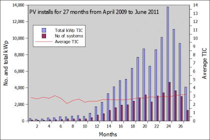

Here's a graph of the most recent 27 months for PV installs (taken from the OFGEM data mentioned above). Now that I've SQLed it , it looks like there is some delay between the commissioning date and OFGEM actually getting the data into their figures, so this looks a little different to the figures I quoted before. I expect that when the next quarter's data are released that current low figure for June 2011 will jump up a bit higher, for example.
Anyway, there are currently 42,590 PV systems registered for FiTs giving a total TIC of 120,162 kWp.
I reckon that the payback will just move from 8 years to 10 years again when the Fit drops. Yes there will be a drop in installations in April - everyone will be wanting it done by March 2012 but once April has passed and the sun starts to shine again - 10 years will look attractve again and off we will go until the next change in FiT. We didn't have a problem selling with a 10 year payback and don't anticipate having a problem doing it again. I reckon we'll need April off to recover from the Jan - March rush - then again, I'm always optimistic.
