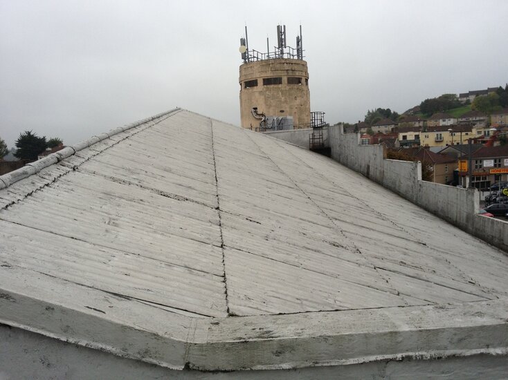

Can anyone advise on a good roof mounting system for a fibre cement roof please. I've looked at the K2, Schuco, Schletter... but nothing in my opinion seems to be that good for this roof type. The roof is a bit old so clamping to this roof with a rafter bolt will probably crack it!. The client doesn't want to change the roof yet but will at some point in the future.

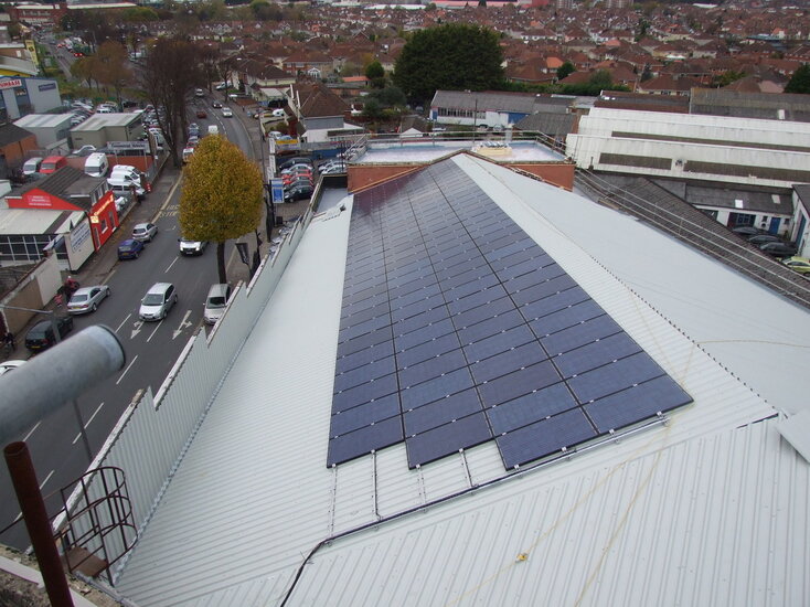

So long as the underlying purlins are sound, you literally put new purlins over the top of the existing roof, anchored down to the existing ones and then put the trap stell on the new purlins, usually down steel purlins on steel purlins, not seen it done into existing wooden purlins. Like EVERY project we do we have structural calcs down first to ensure that the additional load including the overclad is OK, - it's a failrly standard roofing practice, - did it here: (the existing roof is under the nice new trap steel :)

Thanks Worcester - I'm not sure the customer will go for the additional expense of the trapezoidal roof solution, however, I will run it by them. This job is only for a 4kW system and I'm not sure the customer will want to go for the additional cost of the trapezoidal solution, but I will encourage the benefits. I will get the local council to first verify the roof is not asbestos and take a view from there. The purlins are concrete and I will get our structural engineer to perform his usual checks before proceeding further.

If the roof is pre 1995, it will asbestos cement, so I would treat it as asbestos and do as the HSE guidelines recommend.
