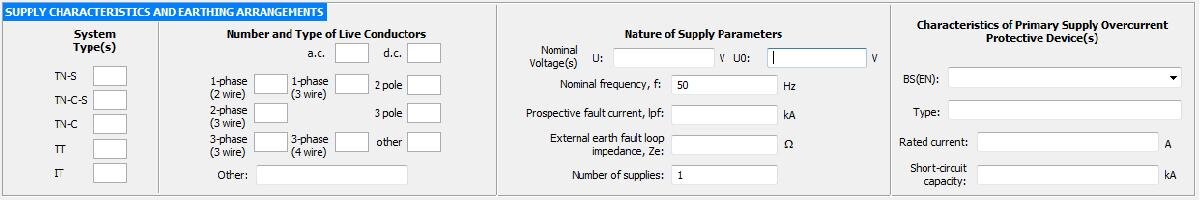

Filling out the above for a Sub board (D.B 12)
TN-S
TP&N
There is no board fed from abnother board, there all split in henleys straight from the meter.
D.B 12 is single phase.
Im getting Zs of circuit 1 as 0.22
R1+R2 as 0.06
Previous PIR's show Ze as 0.22 but how can this be if a circuit Zs is 0.22??
I cant isolate the entire building to obtain a true Ze reading.
PEFC at D.B 12 shows up a Ze of 0.19, obviously this is not a true Ze due to the amount of earth paths.
Just abit baffled on filling this one out for this D.B 12
Or maybe its getting late and im just being dumb!!
