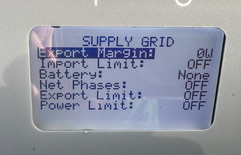

I've finally found a customer rich enough to want a Zappi, and by heck it's so much nicer to install than the budget brands!
But I wonder if anyone has installed one with recent firmware?
All of the documentation and training videos talk about Device Limit and Grid Limit which make sense.
The latest manuals I could find uses these terms too.
But these terms seem to be missing from the menus on this one. I have:
[ElectriciansForums.net] First Zappi Install
I have CT1 setup as grid and working correctly, but need to configure it for a 60 amp supplier fuse.
Can I presume it has quietly become "Import Limit", or should I be using Power Limit in kW?
I hate it when manuals and firmware differ! I've also emailed Zappi support (almost no phone signal here) but thought there's a chance this place might be faster for a simple question.

Grid limit is now import limit.
