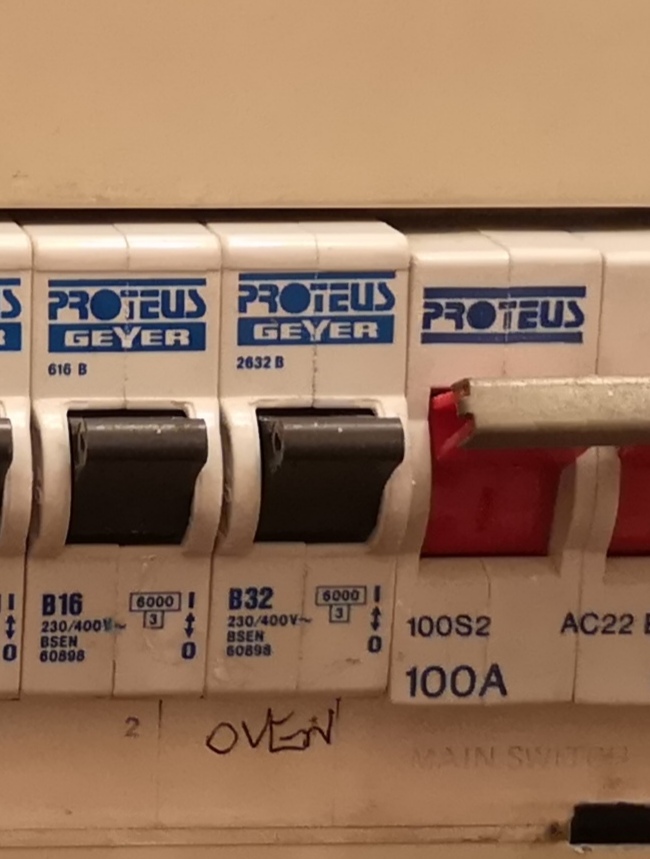

I have an existing 32A cooker circuit with a wall switch with 13A plug hole.The manufacturer says the new oven is hardwired and is 16A.
Can I just replace the breaker in the consumer unit with a 16A one and use the existing wiring?
Current breaker is a Proteus 2632B which is now obsolete. I haven't opened the consumer unit yet to have a look, but am guessing the 2632b is double pole, as they also used to do a 632b version, though can't see why it'd need to be double pole?
If it's din rail mounted, can I use any 16A b type breaker?

Connect straight into the cooker outlet where the old one was, no need to reduce MCB unless manufacturer specifically says protection by 16A mcb
Some sparks and kitchen fitters are really ---- about reducing the mcb to 16/20amp as that is what most new ovens come 'rated at'
but in reality it will only draw 16 odd amps so it doesn't matter if its on a 16/20 or 32amp mcb imo
I never bother swapping out mcbs on old cooker feeds , but I know others who will stick any old 16a mcb in a board as an extra on a kitchen job and charge the poor home owner £100 just for the trouble
assumint]gthe cableis 6.0mm, then you leave it on a 32A MCB as posted previously. although it's a proteus, might not work anyway so a 16A would only make it fail at a lower level.
Ovens are fixed load, so won’t go over 16A… and having a socket could add another 12A to the load if you’re, say. Boiling a kettle and cooking at same time.

Thanks for the quick reply - I did think that the load on the socket + the oven being on at the same time might take it over 16A, so good point band thanks for confirming that. The oven hasn't arrived yet, so can't check the manufacturers install instructions. Just checked the oven I'm taking out and it's rated at 3kW, so same story there.

Funny you should say that, as the main reason I'm asking is that on the supplier's website and another supplier's website that I looked at before buying, every oven that needs hardwiring apparently needs to be supplied by a separate 16A fused spur and they offer their installation services for 100 quid. Maybe I've misinterpreted the bit about the separate fused spur, as I've already got the 32A cooker circuit and thought of it as a spur off the 32A one, whereas they're just meaning you can't wire it into your normal '13amp plugs' circuit, but it looks to me like they just want to sell you their installation service...

Just connect to the existing cooker supply no need to downgrade fuse
The oven manufacturers are pretty woolly when it comes to installation manuals.
They could say “at least a 16A supply” but they tend to be international models, sold across Europe, made in some other country and translated into English by a 12 year old.
Only in the great United Kingdom that we reside do 13A fused plugs exist… so the majority of these ovens are wired into 16A radial circuits. The UK being a minority market.
