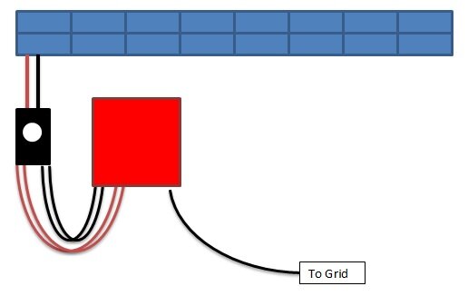

Hi,
On a recent installation a new subbie wired up 1 string of 16 (CS6P-250P) where there should have been 2 strings of 8. Scaffolding came down yesterday but now system has an over-voltage shutdown, not surprising really.
Question is ... can it be fixed by asking them to split the incoming single string into 2 in the loft? It seems that this would halve the voltage and solve the problem, it is a dual MPPT inverter (SB 3600TL-20) but no shading so not a problem if independent MPP tracking is no longer possible. The max system voltage of the single string will be 668V which is within the panel and cable limits (1000V IEC) so I don't see any problem. Am I missing something? It almost seems too simple. Obviously I'd rather do it this way than get the scaffolders out again and rewire on the roof.
Cheers,
Matt
how do you mean split it in the loft? Presumably there are only 2 wires coming in to the loft from each end of the string, so unless there's a convenient skylight someone's going to have to go back out on the roof to split it into 2.

My idea is to split it downstream of the DC isolator. Somehow it doesn't seem right but I can't put my finger on it. But this is the theory behind DC combiner boxes although we haven't used them before.

that would halve the ampage, not the voltage, which is the bit that you couldn't put your finger on.

That would reduce the current in the cables by half, but not the voltage. Think series/ parrallel batteries.
How have they been wired ? up / down / along / up ... or along...... up . along.... if the later then you just need to disconnect the cable joing the top to the bottom row on the end panels and then run a pair of cables connected to these back into the loft and then along the rafters to the same point that the other wires come in, so as not to create a big loop of dc cable (see new guide for reasons)
