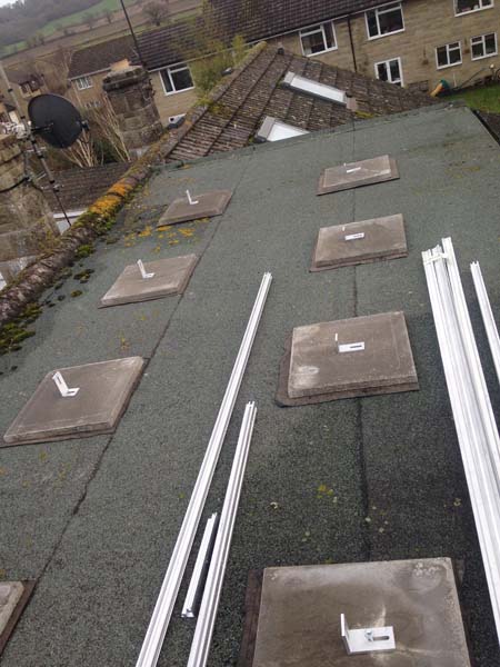

Hi there new to this forum but I have used the renusol bucket kit with ballast and straps on the back of the panels but i find this way much better as it all strengths together due to using one slab with a felt tile underneath for 2 rails therefore tieing all the panels into each other so with less weight you have a lower less on view system..
Many points and reasons i can make why this is a good way of doing things
