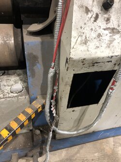

Hello, I am looking for advice on an alternative to metal flexible conduit.
I do work in a factory and the remote foot switches and controls are wired with flexible steel conduit and constantly get distroyed. They were originaly just steel and were changed to pvc coated and lasted a bit better but ultimately failed. I am thinking some hydralic hose but im worried it might not be as flexible and wont lie flat on the ground.
Has anyone had any experience with this before?

No they like to move them around for different jobs they are doing with the machines. Here is an old photo I found on my phone of the damage

That's not wear and tear, that's vandalism! ?

That looks like the cheap and cheerful bog standard flexi conduit which isn't very robust.
We used some stainless steel flexi conduit for a particular job once which was very robust, but also about 4 times the cost if I remember.

Ohh, Yeah that was the ‘original’ stuff. Then we tried brand name kopex, then the coated kopex. The machine was bought second hand and the oem parts were long gone by the time I seen the machine

Oh it wont offend me. I am well aware of the quality of the stuff! Plus that stuff has the benefit of double up as a stanlet knife when it splits.
