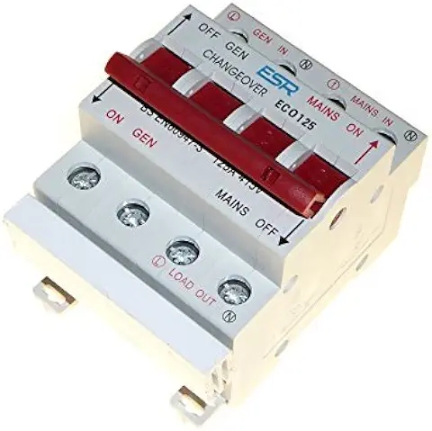

Hi Kim, I back fed the system, via an unused cooker breaker
in the kitchen, I have found, but not yet purchased a special
change over breaker, where the Grid is on the top at one
side, the solar is diagonally across at the bottom and the
consumer unit is on one of the other empty places, I don't
remember which, I need more information, to see that it is
robust enough, to be safe, similar to the one below, which
is 125 amps.
Mike.
