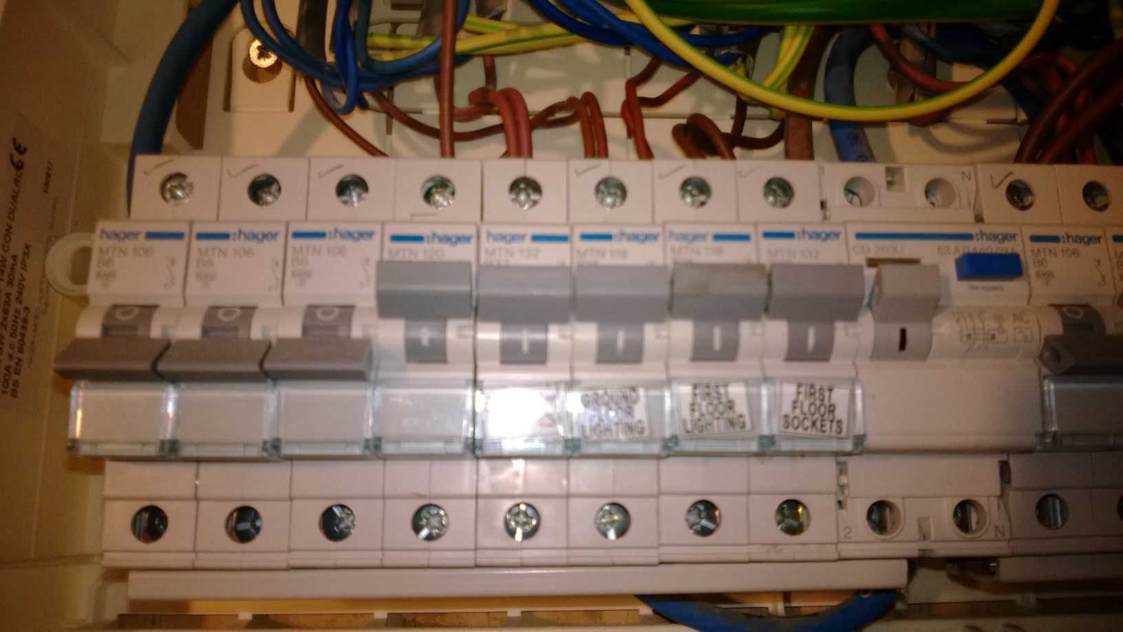

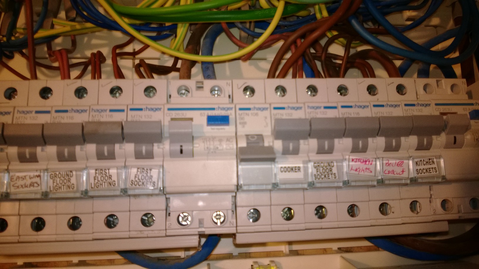

You mentioned never having seen a domestic CU that had been wired entirely as RFCs. I just found these pictures. It was a DIY/homeowner self build. The far left circuit is the only radial - a feed to the shed!

Lol.....having said I've never actually come across a lighting RFC I often hear people (usually non electrical who like to 'talk the talk') describing lighting circuits as 'lighting rings'.
I wonder how many of those circuits in that DB would test out correctly as rings? Be a long EICR test,I hate testing RFC's!
I take it this is in response to the “ring too long” thread where I stated I used rings for lighting.
I could guarantee the lighting rings or any circuit I installed would pass any test you could throw at them.
As said in that thread, I chose to over engineer just about everything. Through my job T&E cost next to bugger all. A few extra yards of cable made no odds to me.
Essentially a 5mm radial then!
NO, it is a 2.5mm RFC only serving a single 13A socket for a plug in cooker. A bit over the top when just a 2.5mm radial would have done the same job.
As for the lighting RFC topic, not a problem! Multi story car parks are wired like that and any other long run for the same type of install/building to save on cable. In a house, eeerrrmm I'm sure there is a reg saying that any RFC needs to be 2.5mm or greater???? I'll have a look at that in the morning. Either way is does not matter, it is just a Lighting RFC with switch drops and more of it to test. I cant see any problems with it.
If it is only serving one point then it would be better described as a parallel feed or just 2 cables in parallel.
Try and write that on a test sheet! I know what you mean Dave, yes you are correct that a single point of consumption in this case would class as a parallel path. How would everyone else test it if it came up? Is it a RFC if only one point is served or is it a Ring??? Well it is a ring at the DB regardless of how many points it serves???? (ok it is a parallel circuit, but it is not 5mm)

The post comes out of that thread, but not specifically 'targeted' at you. I was looking for some other photos and came across these.
The customer was having a house built, lost his job and had to try and finish the house himself. He took advice from his old sparky he used when in England. He didn't know what qualifications he had, if any; but said he'd been an electrician, 'man and boy'. Not a Electrical Trainee on this occasion. The irony is that whilst he was trying to save money he's spent thousands extra on cable and accessories.
You test it as a parallel feed, the ring final tests won't be necessary on a single point.
