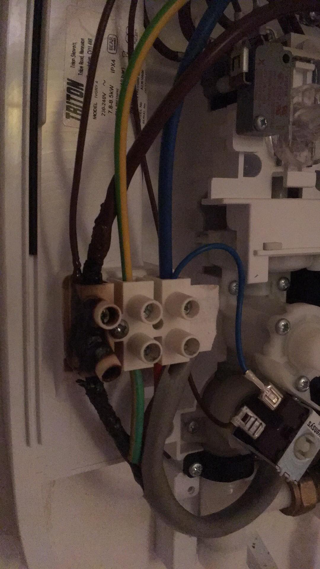

Friend says to me, "can you have a look at my shower. It smelt of burning, I turned it off and took the cover off. This is what's happened"

Just got back.
Loose connection
Wrong polarity at the shower. Correct polarity from C/U to pull switch.
Reterminated conductors, sorted polarity. Rcd tested fine and Zs was good. All good.
I did wonder that I could not prove what conditions the 6mm t+e was installed in the loft and around the house. If worst case scenario the cable is underated.
Without ripping the place apart I'm not sure how you can prove installtion method

What watt rating is the shower?
