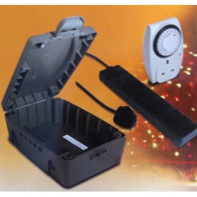

example.
Masterplug Weatherproof Outdoor Power Kit. [ElectriciansForums.net] Garden Pond Electrics.
Fitted to exterior wall of house, fed via the extension cable supplied in conduit up the wall into loft space into socket outlet.
The pond pump and lights come pre wired and plug into extension inside weather proof box.
Do the pond pump and light cables have to leave the pond then be buried straight away in conduit or can they be on ground level in conduit.
Obviously if my feed cable was going a long way across the garden to the box, I would bury that, but the pond is within 3M of the exterior wall where the weatherproof box is.
Part P 5.7.5 states all electrical connections should be made in robust water-resistant junction boxes having IP rating of IP55 or better. These Weatherproof outdoor power kits state on a sticky label IP54.
Anyone had any dealings with these type of kits?

The pump flex will be 10M long, and the length from where the flex leaves the pond is 4M max, so after the buried route will still have stacks left over, is it ok to cut it, or does that break manufactors instructions.
would you burry it in earthed conduit, or is solvent weld 50mm waste pipe sufficient.
most people seem to say run armoured across to near pond, but this is near pond and best place for weatherproof box is on house wall
Any advice would be great.
I know regs say armoured cable hurried across grades, but why do I get 10M of pond flex.
they give you a long flex as some people need a long run,should be ok shortening it provided that it is fused on its own fuse with same rating as one in the fitted plug,or as specified by manufacturer,hope this helps
so running the pond flex through burried conduit is ok as per 522.8.10 as long as it is metal to provide equivalent mechanical protection to armoured cable. that is how I interpret this reg.
The builders guide 5.7 says burried cables to be enclosed in conduit or duct, no mention of metal conduit.
I understand that, but is it definitive that I have to use metal conduit? and if so, what size do you guys use, coz metal conduit for underground must be treated for corrorsion, so what types and any links you know of.
I will plump for metal, but just can't seem to find where it states, 'It must be metal conduit or ducting!'
where this will be is low useage land, just a few plants around the pond, and doing it properly with marking tape, correct depth of burrying, good quality plastic conduit should suffice shouldn't it.
