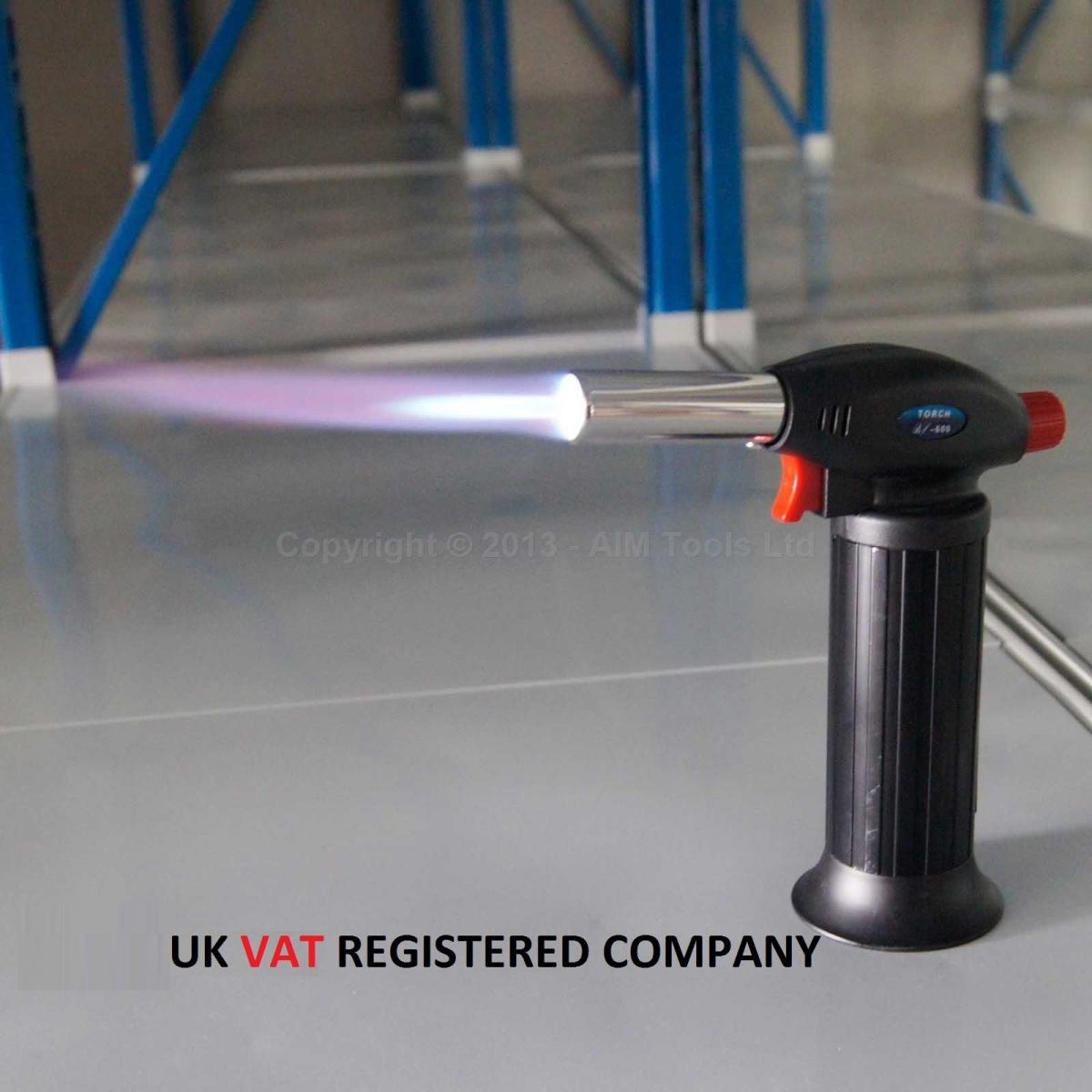

I am looking for the best way to shrink heatshrink (cordless)?
I have used the Iroda micro-therm which was awful so I bought a heat gun to use instead, see pic below. However, I find it too much for heatshrink and after a few seconds (even on low setting) a flame envelopes the heatshrink, although this doesn't damage the heatshrink I would like more control.
[ElectriciansForums.net] Gas soldering iron for heatshrink?
I notice a gas soldering iron is mentioned and this is what I am erring towards, is this effective? Does it take ages or is it fairly swift? Any other suggestions, flameless heat gun?

In the end I bought one of those crème brulee torches, got one from Currys; Buy KITCHEN CRAFT 20 MC Professional Blowtorch - Silver, Black & Red | Free Delivery | Currys
Fine with heat shrink as long as you turn the flame down low, burnt a few puddings with it as well :frown2:
Thanks Midwest but that looks eactly the same as my present heatgun (see pic above) which I'm not too keen on. It shrinks it very quickly but after a few seconds envelopes it in flame (even on low setting) so I would like something less powerful.

If you have the flame that high, its gonna melt the copper cable, let alone the heat shrink :cool3:

Google pencil torch or windproof lighter. They're less heat output than the blowtorch in your opening post, I also find the chef's blowtorches to be too hot unless you're using it on big diameters like 50mm and over.

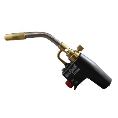

I usually use a miniature propane torch which is about the size of a largish cigarette lighter, something like this [ElectriciansForums.net] Gas soldering iron for heatshrink?.

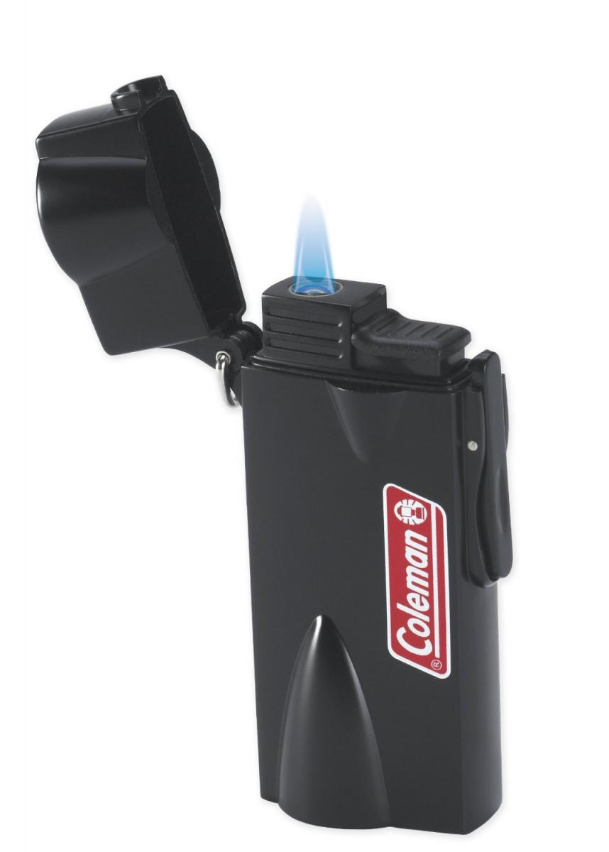

You can actually use one of those windproof lighters for the smaller heatshrink sizes.

With the gas torch generally they are very limited on flame / heat adjustment
it's easy to burn the heat shrink if you you don't move the flame about,
I tend to keep it moving but aim off to the side of the heatshrink, but a heat gun will do exactly the same on a high setting,
Using low setting can take a bit more time
Personally I prefer the small creme brulee type
I've also just bought a small cigar lighter in china which you can angle the head it's all made of metal and holds a lot more gas than the plastic version I have also has a cap on a chain which is a bit of a nuisance but when fitted the gas cannot be ignited so I'll keep it attached just for the safety aspect
