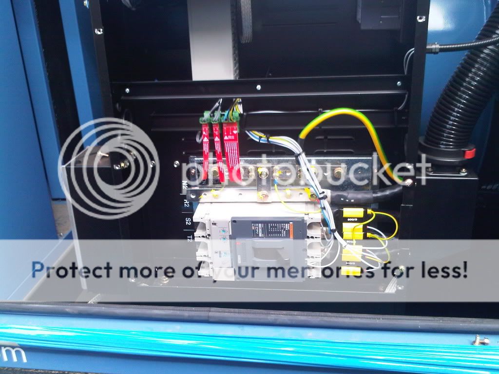

The generator has a 630Amp merlin Gerin MCCB, i was going to use 2*300mm 4core s.w.a. cables, until i went and paid a visit to have a look at the generator, and was amazed at how little cable, glanding and termination space there was. So we done some re-calcs and now decided to use unarmoured singles (2*185mm tri-rated per phase)

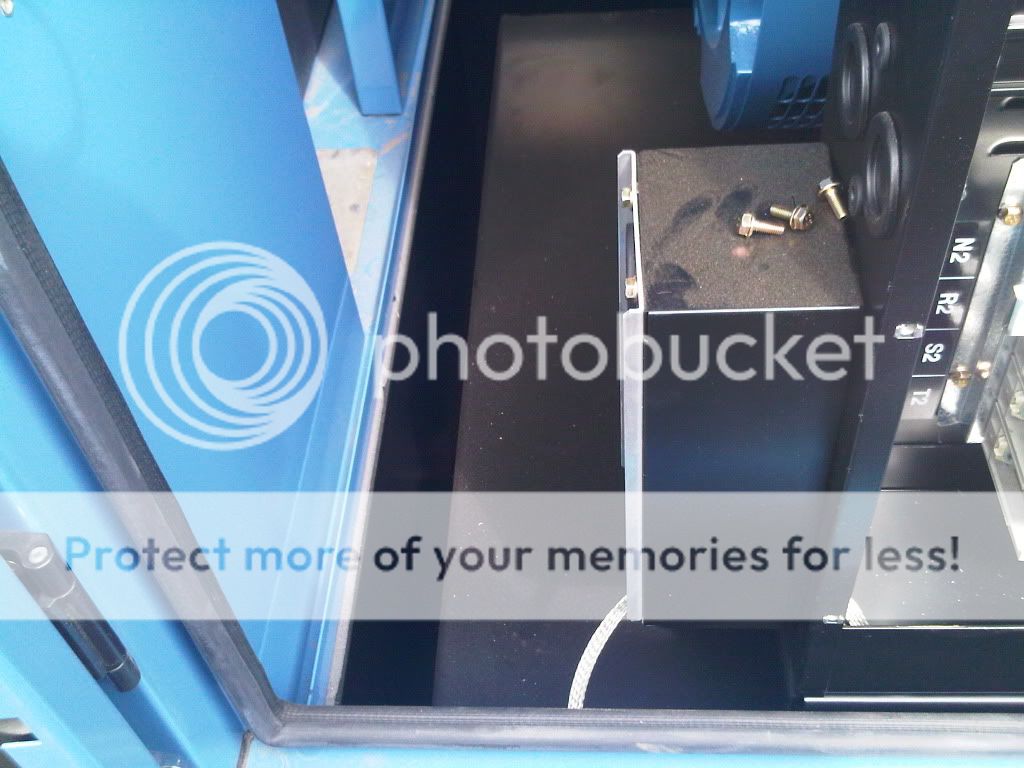

well, gonna give posting a pic a go :cool:
that gland box is going to have a new home in the bin, going to manfacture a larger gland box where the singles will come in through the rear and hopefully have enough of a bend radius before connecting onto the mccb. its a lot of arsing about i must admit, hopefully the next ones the geny manufacturer will leave enough room for cables.
Can you imagine trying to make off 2*300mm s.w.a. in that enclosure:eek:...stuff that.
Might be worth a call to the manufacturer, it's possible they might pick up the tab for any mods if they accept that their kit is not fit for purpose.
