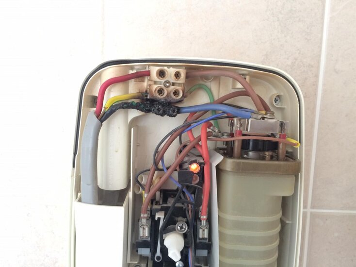

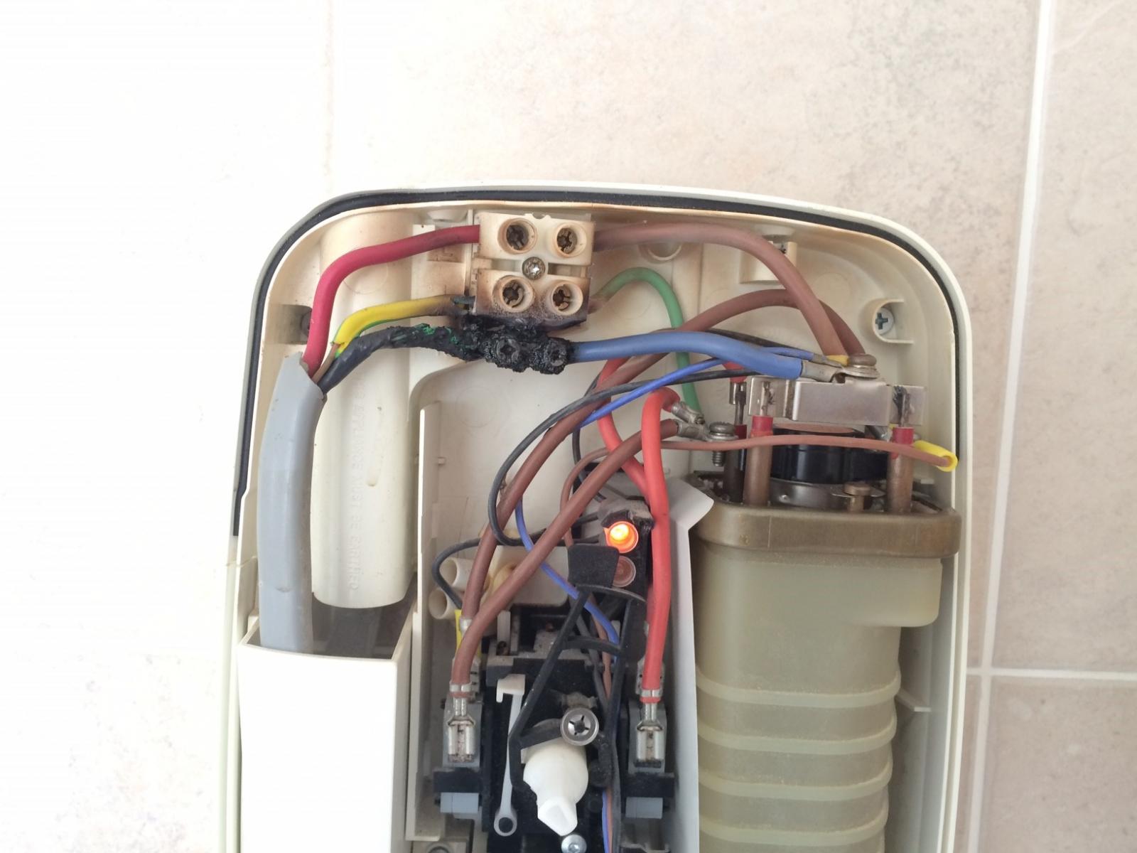

Removing and old consumer unit yesterday, I'd say 90% of the terminals were loose. I also found the shower neutral had been loose too (pic). There was also no continuity on r1 and r2 of the ring circuit, upon removing two items in the kitchen, the lives had both dropped out of the terminals.
So no, I don't think you are over-reacting.

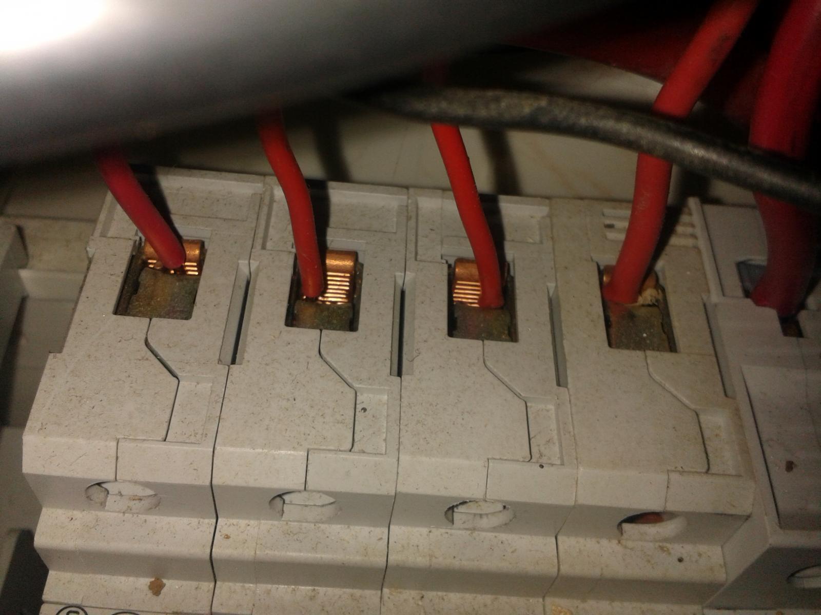

I did a job two years ago where working on one circuit in a CU I routinely checked the connectors on the other MCB’s to find 6 were loose including the two pictured below. The two lighting circuits had presumably been forgotten completely and since I was the first person to work on the CU since the occupiers moved in 5 years previously they were very luck not to have had a problem.
Some people are just careless.
