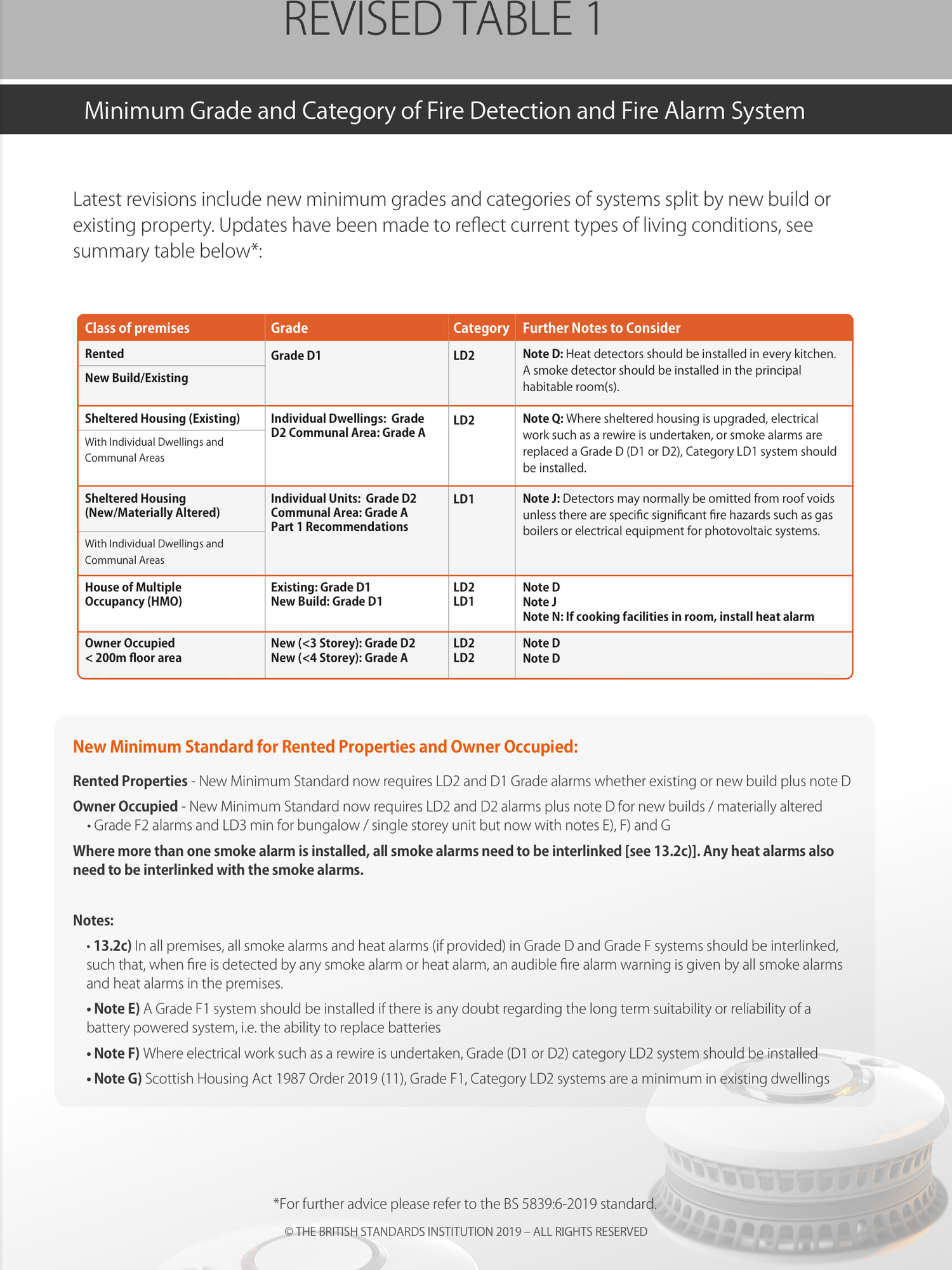

Do Grade F1 smoke detectors with 10yr sealed battery and RF linking capability satisfy the BS 5839 -Part 6
No not any more only a LD2 D2 is minimum. For new or materialy altered
F2 are allowed in bungalows,
[ElectriciansForums.net] Grade F1 Smoke detectors
I enclose the table as its a little confusing.
It depends on the property you are using them in they are ok for existing owner occupied properties but new build owner occupied and rented properties must be D2
