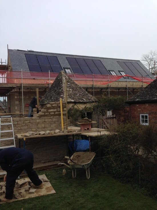

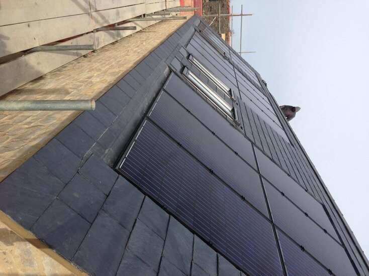

Did first GSE last week. Not a particularly smooth installation because it is a new build small retirement house and we are trying to put as much pv on as possible which puts it tight against velux flashings. Sequencing roofing work, pv work, velux work was tricky. We also made it harder than it had to be because client/architect wanted slate flush with top of panels which requires extra counter-battening and sealing. Some observations:
- Laid out battens to support trays, put trays on, then roofing battens went on around them. Some trays had to be lifted again to allow roofing battens to reach under to attic trusses rather than flap. It would have been quicker to just batten the whole roof as normal and then add extra battens for the trays if some were missing from critical areas.
- Used the phonosolar panels with built-in solar edge optimisers. A cheap and quick way of doing it, but they do not fit on the gse trays the 'right' way up in portrait format. The optimiser hits part of the tray. You have to mount them upside down (optimiser at lower end).
- With panels being mounted on the trays 'upside down', the routeing of the cables means the cables are too short to go from one panel to the one above it. You need to fabricate an extension.
-Agree with The Solar King that top flashing is not really necessary. We did put it in but it does not really show because slates reach almost to top of panels. The top flashing clips onto top panels which I do not think is helpful. Beter to be able to put all frames and flashing in place, then all slates and then panels.
But I think it willl look ok. Certainly economical, apart from my time co-ordinating it.
Will post photo's of the new build install from above as finished later this weekend.
We installed right to the ridge, and had a good roofer to work with - no flashing at the top - he is installing a batten between the joints in the panels and putting his ventilated ridge flashing over so no way way water can even get blown up (this is zone 4 :) )and then screwed down ridge tiles - note all new builds need positively fixed ridges, hips and edges so that makes this a bit easier.
Roofer is really please with the end result :) (Oh so is the client :) )
