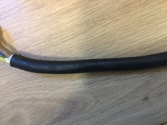

Found the old cable, pics.

That doesn’t look like H07 to me.
Its marked as Vede H07RN.

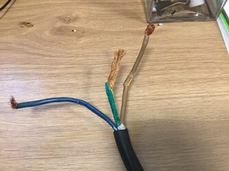

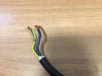

The shorter stripped end was terminated in a junction box (in 15A strip connector!) and the longer end was terminated in the appliance. These longer stripped core's, were me pulling off the outer sheathing, before I realised the cable had had it.
The cable is not very flexible!
Started to have a look at the other appliances in the kitchen, seems to be the same sort of cable. None seem to have the same rigidity as this damaged cable, but I think further inspection is needed. I think if they are same source of cable, they might need replacing. We've got fryers, steam ovens etc.

The whole point of H07RNF is its ability to be flexible and take the knocks and abuse because of it being rubber - that‘s why we use it by the mile in the events industry. Depending on the use/method it’s normally rated 60c to 85c. I‘ve also rarely seen it with a cotton core below 10mm sizes for 3c. As others said originally - I suspect what you‘ve got there is a rogue knock-off used at the initial installation - you might want to look at swapping it all out. Regardless…… it shouldn‘t have deteriorated like that.
rubber is not resistant to oils, could it be airborne oil mist or fume has helped it deteriorate faster?
H07 is a funny tigger…. Inner cores are Rubber (EPR) but the outer sheath is actually Polychloroprene which IS oil resistant. And from practical experience of having retrieved enough over the years where its been used to supply catering concessions I can absolutely vouch for that!!
