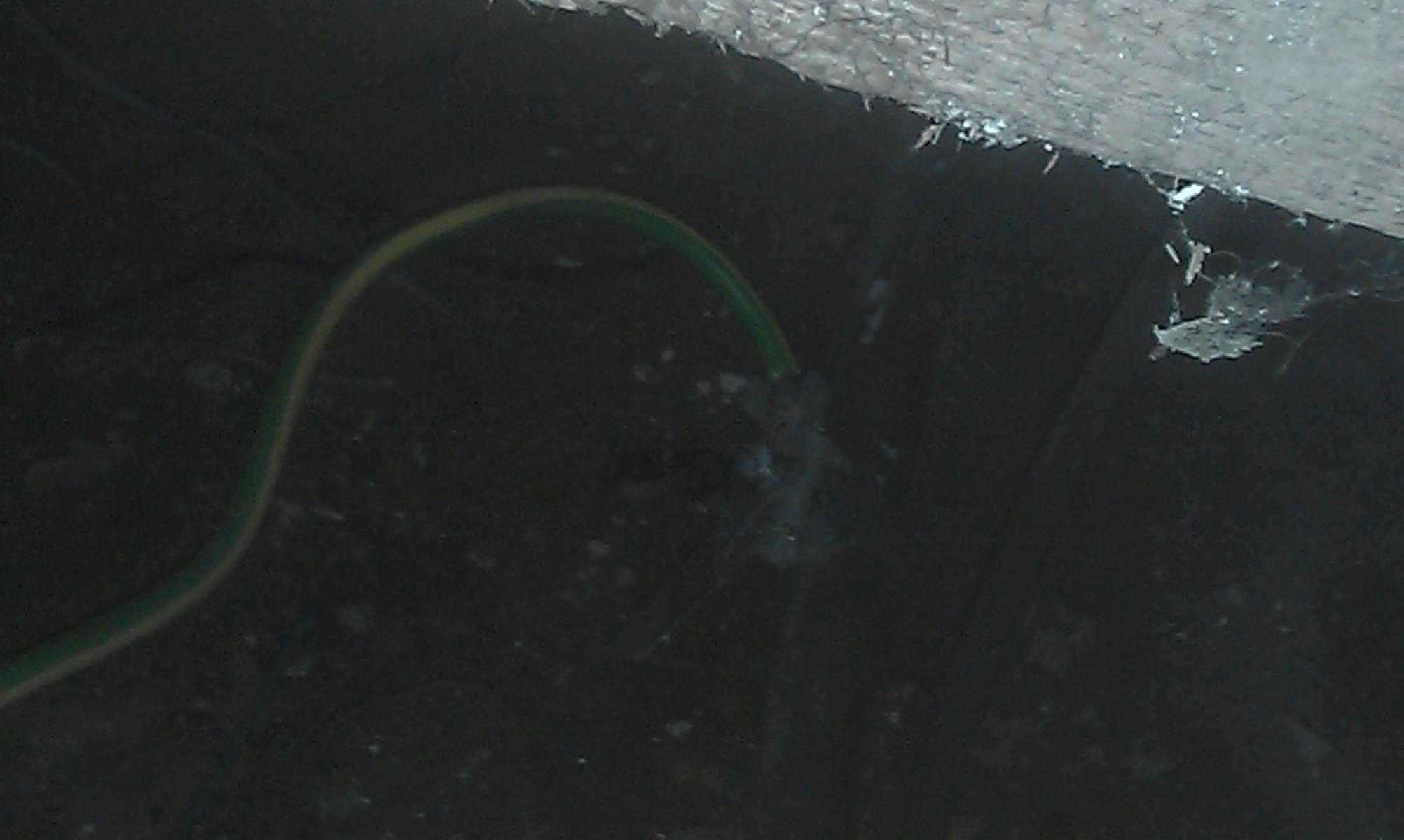

Out comes the circ saw and I take up the boards around the service to see if its and old 951 clamp hidden away, but no, nothing. So got the work light under the boards to be greeted by this beauty!
[ElectriciansForums.net] Had a cracker of a job today
951 clamp onto the lead water service in the floor void. This being used as the earth connection.
They spent 3k on a rewire earlier this year. Not a single cable entering the CU is new, not only because they're all the old colours, but they're all still painted up in emulsion paint. Then I find no bonding to either gas or water and only half the new CU has RCD protection.
Had DNO out who confirmed that there had never been an earth supplied since day one, yet no earth rod insight. Good thing though DNO are back out tomorrow to sort an earth and change service head.
Since getting home tonight, my brother has gone back to update the customer regards his so called rewire and got to speak to the spark who did it. He blamed the testing on another guy who tested it all, confirmed that because there was no supplied earth they had used the water supply and when asked what readings he got for their Ze, he started stuttering and all of a sudden was lost for words.

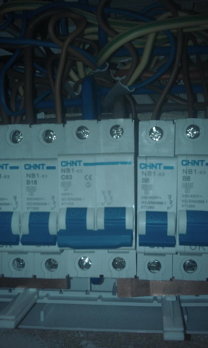

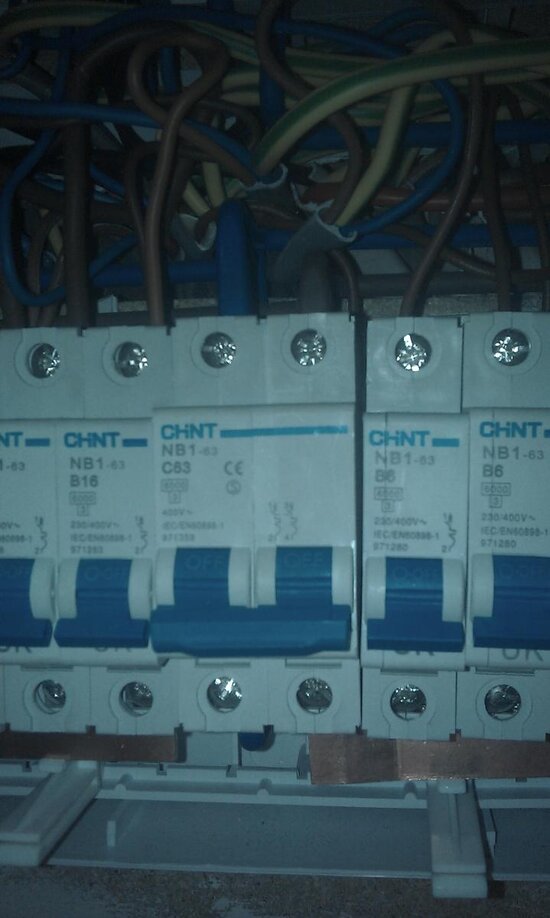

This pics also makes be wonder. Its a dual RCD chint CU, but in place of the first RCD their seems to be a 63 amp C typre DP MCB instead. God only knows what his plan here was.

That is shocking. Obviously there is some paperwork to back-up the "rewire"?
Looks like a full refund is in order here...
What's really sad, is that these cowboys are taking work away from good electricians who are trying to decide whether it is worth carrying on in business....
So, to summarise...
1) Customer paid for a rewire which didn't happen...
2) "electrician" (I use the term loosely) connected main earthing to lead water pipe....
3) It was left as a "sort of TT system", but only half the board is RCD protected....
4) "electrician" (I use the term loosely again) didn't understand what Ze means.
To conclude....
The customer was robbed and put in danger.
Now, you can't tell me that there isn't somebody who will take this state of affairs seriously???
Not sure if I'm missing something here, but those cables look brown and blue to me...
