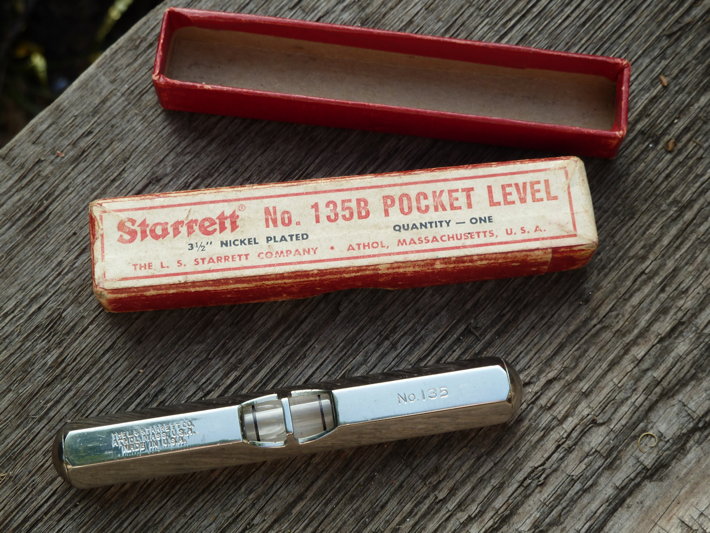

Also with the spirit levels, any particular sizes?
Here's my little pride and joy ...
I use the flat lever bars as in that set. Just cheap ones from toolstation though.
Level lengths depend on what you are doing. Get some lengthy ones if you are doing a lot of kitchen fits, but a boat level for the bag and a 600mm one will do for general duties. Don't forget to consider magnetic ones for the shorter ones.
