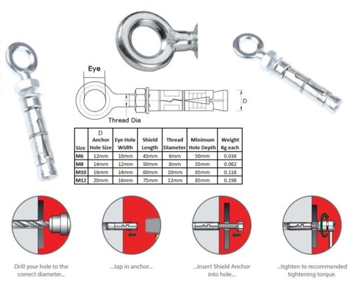

Hi need to hang a 30KG chandelier on a metal stud in a new build apartment. I’m not used to hanging such a heavy light on metal joist so a bit unsure on how to approach this
Im thinking of drilling 3 8mm holes through the metal stud and adding 3x toggle bolts which are rated at 30KG each to latch onto the metal joist. What would you guys do. Would my way be ok or is there a better way

Before you even think about installing this weight of fitting you need to establish what the design loading of the ceiling frame actually is, without this you could end up with that Del Boy moment.
Any excessive point loading could cause deflections across the ceiling or it could sag where the load is attached, for fitting of that weight I would be looking to get some studs back to the solid ceiling structure to minimise the grid loading

It may be possible to reinforce the ceiling frame with an M10 and chain (you may need to rod either side directly next to light fitting)
Or threaded rod using the wall plug from a concrete fixing
This would be drilled through existing frame directly where the light fitting is to go.
Alternatively you could fix something like this
And come from that point with a chain.
Again without being able to see it, I'm just trying to give some options. Threaded rods can also be attached to these

Not sure if any of this helps but I certainly would not trust that frame to hold it like it is.
As above - I don't see how you will be able to rely on a single point of that frame sipporting 30kg. If it was me who had installed the frame then I would void any warranty
Priar to the suspended ceiling going up, IMO an RSJ should have been installed and the shandy chain to it. 30KG is a lot of weight.
I think I would bolt a 1m length of unistrut to the ceiling using 4 x M10 expanding wall bolts as above.
then from the centre of the unistrut put an M10 or M12 eye bolt in to hang the chain from.

Ask the architect or better still the ceiling installation company they may point you towards the manufacturers of the ceiling frame and or fixings
