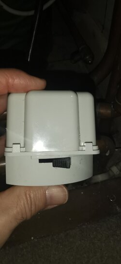

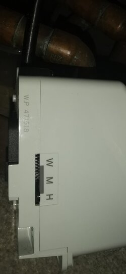

Hi, just taken actuator off and it has a small plastic leaver on the side and another on the back marked W M H, with hot water & heating controller both set to off I couldn't move either leaver/switch

I'm not familiar with that particular actuator. W M H stands for Water, Mid position and Heating. Best to look up the instructions for that actuator to see how to manually operate it.
When the heating and hot water are off the MA1 will still be energised to the hot water position
When you turn the heating on does the lever move to the other position
