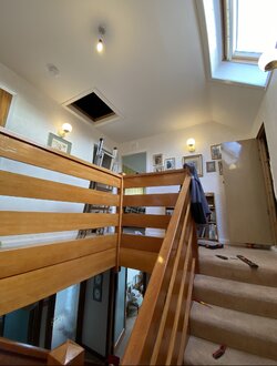

I’ll see if I can describe this without making a diagram.
Tomorrows job is wiring and fitting wall lights at my mother in laws, up the staircase.
There’s a U shaped stair, with a half landing. So 5 or 6 steps up, turn around, another 5 or 6 up. Top landing is an L shape around the open stair…
So basically a square room.
Top landing 2 lights on adjacent walls at a regular height off the floor.
The light at the half landing… the same distance off the floor as the top 2, but obviously in relation to the height of the half landing.
Final light on the 4th wall will be above a stair case.
Does it go the same height as the top landing, or that same distance off the floor in relation to whichever step is below it?
Or do I make all 4 lights the same height, whatever the floor level is. Ie, measure off the flat, level ceiling

No4 Same height off the step as off the half landing and off the the Top landing.
If you don't, the spread of light over the stairs below will look different to below the other lights.
HOWEVER, as above N-b-Dim, make sure it's not you that make the final decision.

The most effective way to light steps is with wash lighting from wall mounted lights mounted high enough to not have shadows on the stairs. This avoids having treads that are in the person's shadow when going up or going down the stairs. This approach requires fewer lights as one light can provide wash light for 4-5 steps/stairs.
Overhead lights or lights mounted in the risers are the worst at providing illumination. You can verify this in advance with a helper holdiner a flashlight at various locations.
So I put the two at the top at 6’ off the floor….. the one on the half landing at 6’, and the one on the stair slightly higher. It looks too low just measuring off the step, and trying to keep it level with the two at the top, it was too high.
[ElectriciansForums.net] Heights of wall lights on a staircase
I sent the wife the photo, and she said it was too high.
Considering it’s a hallway, I didn’t want people walking into them. I told her it was a standard height for that reason.
If they do think they’re too high, I can always turn them upside down on the bracket, so the ball is hanging lower.
They’re going to have to rearrange the picture frames… the half landing wall is choka
