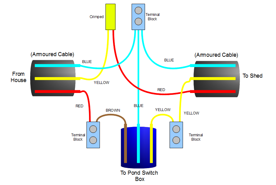

I have drawn up a diagram to show the cabling more clearly - you can compare with the pictures above:

My first question is, assuming the colours are associated with the correct power points - i.e. RED/BROWN = live, BLUE = neutral, YELLOW=earth, does this cabling seem correct? It doesn't to me as I would expect all the like colours to be connected together, as per?:

I have to admit that if your first drawing is correct the blue does seem to be the Neutral and then you do have a mish mash of colours that do not make a lot of sense.
The Red SWA from the house would seem to be the line to the pump switch, and the yellow from the house becomes the red to the shed but whether that and earth or not is open to conjecture.
I personally would as you say disconnect everything, making sure it is dead and start to trace things out, if you feel competent to do this
I am unable to view the attachment so cant help you with your JB, I get
"Invalid Attachment specified. If you followed a valid link, please notify the administrator"
But if you drawing is correct you might have more then one live feed going out there using a common neutral
looks like both the red and yellow of the SWA are used as 2 live feeds. the armour itself must then be used as earth. making sure that this is glanded and made safe is a job for a sparks. as you know, water and electric can make a lethal combination, so i advise you to get a spark to give you a quote for making it work safely.

When I connect just the armoured cabling together, colour for colour, the shed power works without tripping the RCD. If there were two live feeds, on YELLOW and RED cables, then would this actually work like this?

from your pic. 1 , it looks like yellow id L to shed, and red is L to pond. the important part is the earthing. if this is achieved by using the armour of the cable, then, as my last post, if this is not glanded correctly and tested to be compliant, then you will have a dangerous situation that could kill. FFS , get a qualified sparky in.

In the three-way junction box, the two YELLOW cables from the shed and pond switch didn't seem to be connected anything to earth it?

How is the swa connected at the house end? By the looks on your drawing the red and yellow are both lives so if you've now connected red ,yellow and blue to each other you'll have 230v in the earth on the shed! Unless they've used yellow as earth from the house then changed to red for shed, then shed shares the live connected at the pump end and pump has no earth at all! Either way get someone in or switch it all off until you find out whats what
