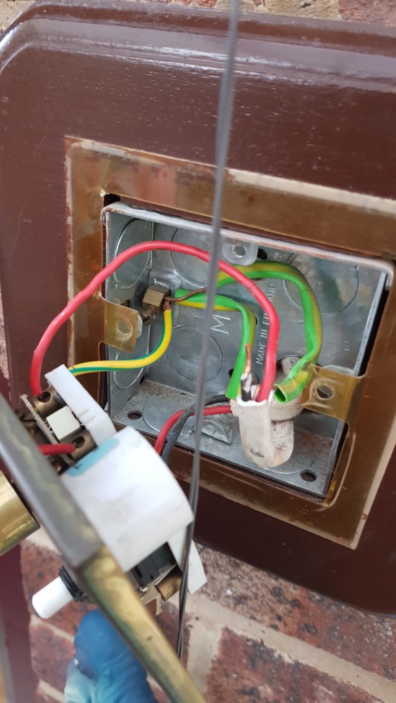

Im trying to replace an existing 2 gang dimmer switch with a new one I bought.
The room has 2 wall lights (operated by one switch) and a ceiling light operated by the other (which does not work). I've installed a new ceiling light which hasnt solved the problem so im hoping a new wall switch will.
I cant wrap my head to why the existing connections are like this and how to rewire the new one.
All i know is that I can remove the extra eart wire as the new switch is plastic?

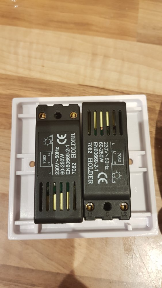

Another quesiotn I have is why the com terminal has no screw for me to fix the wire in. Is it needed then?

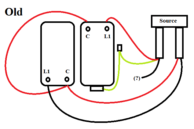

Ive attached photos of the existing wired unit as well as the new one I bought. Sorry, I just realised this is not the clearest so ive tried sketching it out.

You don't need common on those switches.
The drawing on the back shows using L1 L2.
Substitute (new) L2 for (old) C on your drawing.
And you don't need the Earth on the new plastic switch, there's nowhere to put it.
Did you remove that black wire or was it already loose when you opened the switch?
If it was already loose whne you opened the switch I suspect that is the reason your light doesn't work.

the black wire was already loose when I opened it. if 2 way means that it can be controlled by another switch, then no. Just this switch (2 gang). I didnt know whether this black one being loose is the problem or is it loose for a reason and I should just remove it or connect to a connector block?

It looks like it has fallen out of a terminal, I can't imagine anyone leaving a stripped end of a conductor sticking out like that.
You need to investigate and test it to establish what it is doing and where it should be connected.

You've got a joint in the cables somewhere then, is there any sign of a joint box or connectors pushed into the ceiling above the light fitting?
Ah, i take it this is in a conservatory then? In that case all bets are off and it does explain the particularly terrible electrical work in the pictures.

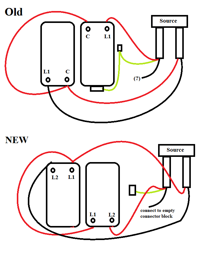

thanks for all your help. I have also had some other advice and suggested perhaps I can simply rewire the new light switch as per previously. simply connect the old C wires to the new L1 and the old L1 to the new L2 terminals? Disconnect the earth wire and also fit the loose black wire to an empty connector block. (see attached diagram)
Was just wondering if that sounds like something I can try without blowing anything up? (of course, I will switch the main fuse box off before doing any rewiring).

Thanks again for your help, now solved đź‘Ť
