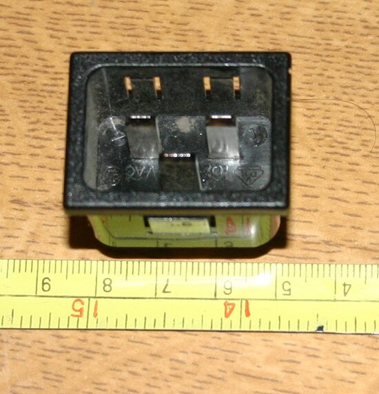

I need a mains cable to plug into this .... Any help appreciated
[ElectriciansForums.net] Help needed to find connector
It's a 16amp ups connector, you'll be wanting a C19 IEC 320 lead.

Cheers ......... job done.. if a tad expensive !!
