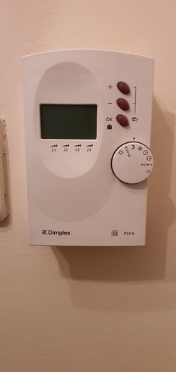

My flat has all electric panel heating and uses a Dimplex PW4 programmer that has died. It's also discontinued, i can see why as you need to be a rocket scientist to set it anyway.
As this is just a switched live switch am i right in assuming it could simply be replaced with any other range of programmer such as Nest, hive etc even though it's for electric panel heating and not gas?

I've seen 3 of these now, all in Barratt flats installed about 2005. Every single one has failed in the same way, with a bulging component on the board - so they clearly weren't well designed in the first place.
Shameful that they don't offer a suitable replacement now though and try to upsell you to their latest expensive system.
I just disconnected them as they didn't seem to offer much benefit, even if you could work them out. From the little research I did, there is just a single live pilot wire from it to all the heaters and the storage heaters had a 4 core input so that the thermostat can override the convection controls.
The 2 recent ones I've seen even had them wired as far as the bathroom heaters so that you could turn those on too (Not actually connected) which mean 3 switches for every storage heater and 2 for non-storage - no surprise that the tenants never worked out how to use them.
In the refurb I did I replaced the radiators with Q-Rad models which are no longer storage, but probably more suitable for tenants who are out at work most of the day.

Ah that makes sense. Yeah I'd basically just left it on continuous as i couldn't work it out.
These are the radiators in the flat. Can't get any to work without replacing this programmer which is annoying as I'd never used the programmer anyway.
So as this zoned pilot wire just seems to be a switched live when the programmer calls for heat I'm guessing most standard programmers should work without the need for another pointless zoned programmer?

Yeah it's a strange one. Dimplex were helpful. They now say you can't replace the programmer as I'd now need to replace every electric heater to all have their own thermostat and programmer for each one.

As I suggested in post #12, I believe the 'pilot wire' carries an encoded signal. I don't believe it's just zero or 230v depending on whether the heater should be on or not. But I have been unable to find any explanation of the pilot wire signalling protocol, so I can't back up this hunch!
Personally I don't think you can use a current programmer to activate the old Dimplex units as originally intended, but I'd be happy to be proved wrong.
Have any of you got pictures of the inside of the failed units? It's probably just a capacitor gone down. If anyone wants to send me a failed unit I'll take a look and see if they can be repaired.
The 'pilot wire' signalling protocol seems to have been a French development, specified in a GIFAM standard. I suspect finally dropped in the UK because the pilot signal seems to be referenced to the Economy 7 Neutral, giving a risk of 'borrowed neutral' problems.
After a bit of Googling I've convinced myself there's little point in trying to control a pilot wire heater from a typical on/off programmer or smart controller. At best all one can do is to switch the heater between 'comfort' and 'Eco' by applying mains to the pilot wire, unless one starts designing something with diodes!
I did find a Test House spec (in English) which has as an appendix describing the pilot wire protocol (but in French!), page 24, if anyone is interested!
So I fear anyone with Dimplex pilot wire heaters are stuck with keeping, mending or replacing the existing Dimplex 'programmer' (some models still available), or changing the heaters.
