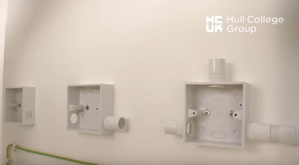

I built myself a practice wall in my garage so that I can get more training in at the weekends from stuff I do in tech and on site.
The difficultly is drilling holes in the boxes and getting them centered and uniform.
Here is a link showing the drawing I've been following and how messed up my boxes are. ?

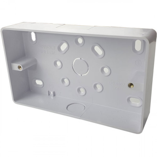

This is the boxes I've been using:
I have only now found out that you can get them with knockouts. ?
But the problem is that they don't have any side knockouts.
Any advice on how I can measure the boxes to get the holes centered and in the same location across them all? In college the holes where already drilled and they didn't show us how to do it.
The LAP box isn't suitable for conduit entries even though you could probably make some with a holesaw it will be tricky as that type of box is prone to shattering. The Tower box won't have side entries due to the face plate fixing lugs so you are probably better off with metalclad boxes which will have entries to all sides.
Couldn't they just place the knockouts above the lugs on each side? That's where I've been drilling with limited success.

You can drill the Tower type boxes, they're made of a softer plastic to the normal surface box.
And they don't have the T&E knockout weakspot at the back of the box, which is why yours have shattered.

But then how do I get the side holes all the same. I'd just dvide the length of the box in half to get the center point and do the same with the depth.
But that would put me where the lugs are. So do I just divide the length again to get into the corners?

You need the midpoint of the space between edge of the box and central lug.
And low enough in the box so you can't get your fingers down the back of the conduit against the wall or board.
To get all the boxes the same, stack them all up against each other and mark a line across all of them.
Example of side position below, nicked from link below that,
