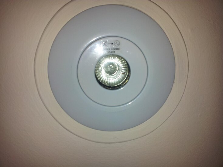

Hi Guys
My mum has had these downlights fitted into her new bathroom, and 1 has blown.....
She got it from Screw Fix, and all the info. isn't helping me determine what sort of method I should use to change the lamp, but it is a Circular Low Voltage Ceiling Downlight 12v...
[ElectriciansForums.net] Hi I'm Keiramackenzie - Anyone know what downlight this is and how I change the bulb?
I have researched downlights, the types - the screw lock, the clip etc, but I still cannot find out what sort of lights she has, or how to change the lamp.
What is this - It's not a twist lock one is it? Or Magnetic? I doubt it at the price, and can I replace the bulb without completely removing the housing? Surely that is what the centre ring is for(?)
Any help, as you can see , would be a god send, and help me out greatly
Thanks guys
Keira

Hi Keira!
It's a 12v diachroic lamp, look in the screwfix catalogue for a MR16 lamp.
If you look there is a spring clip holding the lamp in, you can just see it up against the glass of the lamp, if you flick it out with a screw driver then the lamp will drop down .

Re: Hi I'm Keiramackenzie - Anyone know what downlight this is and how I change the b
If your picture is correct, the glass you see is the lamp bulb!

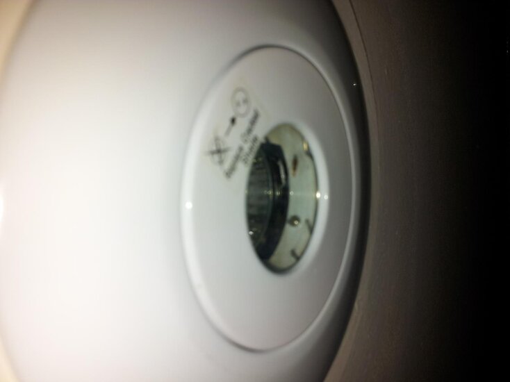

Here is a picture.
  • [ElectriciansForums.net] Hi I'm Keiramackenzie - Anyone know what downlight this is and how I change the bulb?
That is a different fitting to the one you posted originally!
I have since taken a better photo, and if anyone can actually help me to know how I change the bulb on this thing, i'd be grateful.

I know I have to squeeze the clips, but how do I get past the glass?

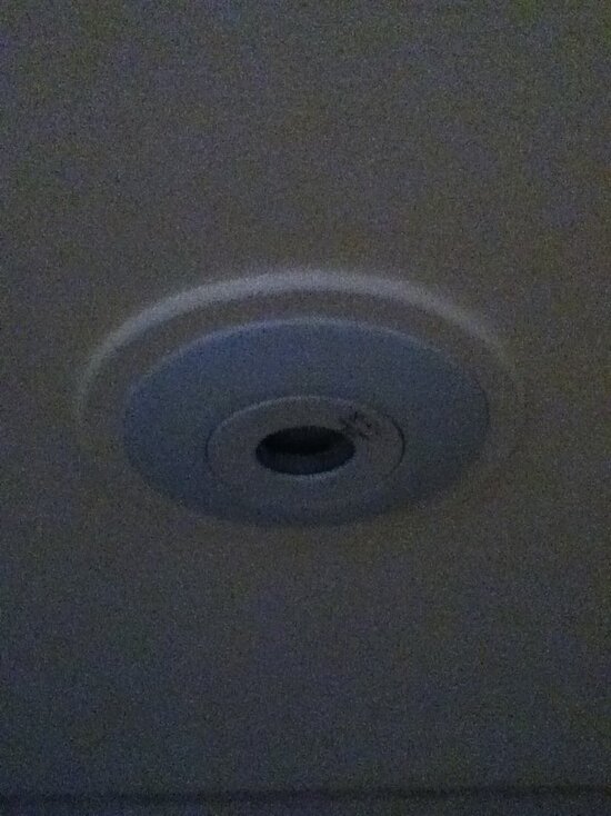

This picture shows the recess above the glass - what i'm assuming is a shade - and below the bulb. I just need to know how to squeeze the ring which is behind the glass.

If the spring retaining clip is behind the glass and not accessible I think you have to prise down the inner round white plate by placing a flat implement in the gap between the inner and outer plates.

Thank you for your answer. I think you're right and did wonder if this may be the case. I think I would know pretty quickly if that was the wrong way to go as well.
Thanks, I'm going to try it
