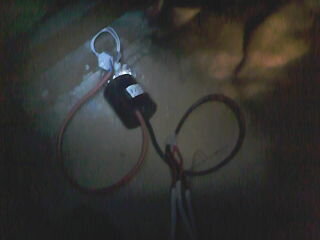

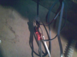

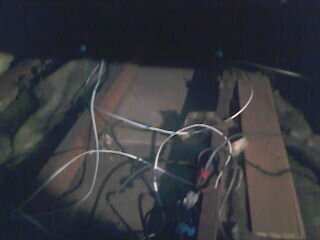

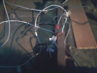

evening all.....
we were called to an old gents house earlier today after he explained that "the bathroom lights kept going off at the fuseboard".....so after a quick consultation with the client when he explained that "it happened when i use the pullswitch"....thought i would go into the loft to have a look........and thats where i found this.....
[ElectriciansForums.net] high flyer!![ElectriciansForums.net] high flyer!![ElectriciansForums.net] high flyer!![ElectriciansForums.net] high flyer!!what you can see here is the cabling for 5 selv downlights in the bathroom.....the work of an RAF trained electrician so i was told by the homeowner.....apparantly theres a load of his "work" at the local golfclub that they are continuously having problems with as well....hmm a real "high flyer"..lol.....needless to say that this "work" in the pics above was condemned and the lamps re-fed in new cable using enclosures for any joints etc....
