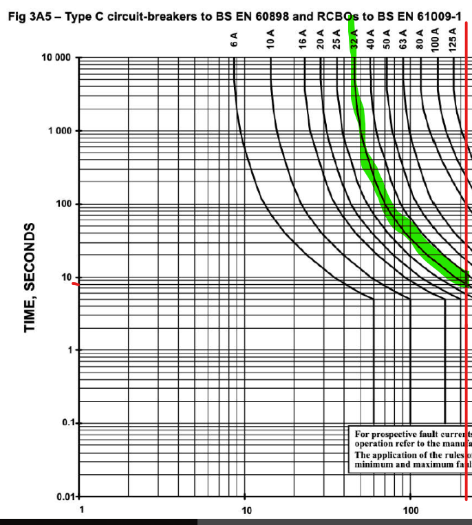

I would add:
Where an RCD is used for automatic disconnection because of high Zs readings, it must be confirmed that the L-N loop impedance is low enough to ensure that the overcurrent protective device operates before thermal damage occurs to the cable.

I would add:
Thanks for the heads up. Please could you help unpack that some more for me or provide a reference for further reading.
