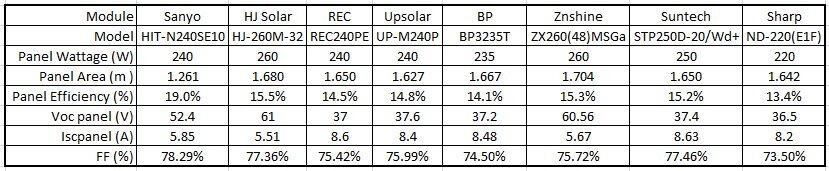

@ Sue Chope
Here's an update for you, it;s something we hadn't done beofre, yet I got an email through saying how important th Fill Factor (FF%) is - FF is not just about the size efficiency it's also to do with how well it converts the light into power, so using their calculations I ran the HJ panels through their analysis
3.Fill Factor
This is a key parameter when we compare different brands of solar cells in terms of their performance. The fill factor is defined as the power of the solar cell (STC) divided by the product of the open circuit voltage and the short circuit current.
Cells with a high fill factor have a low equivalent series resistance and a high equivalent shunt resistance, so less of the current produced by light is dissipated in internal loses. Graphically we can see higher values of the FF means that the I-V curve gets more squared so the maximum power point (MPP as we explained in previous documents) increases
They came second behing Sanyo in 'Panel efficiency' (w/m2) and third Fill factor (FF%)
Here are the results:
[ElectriciansForums.net] HJ Solar PV Panels
Clearly an alternative for those struggling to get hold of Suntech's
