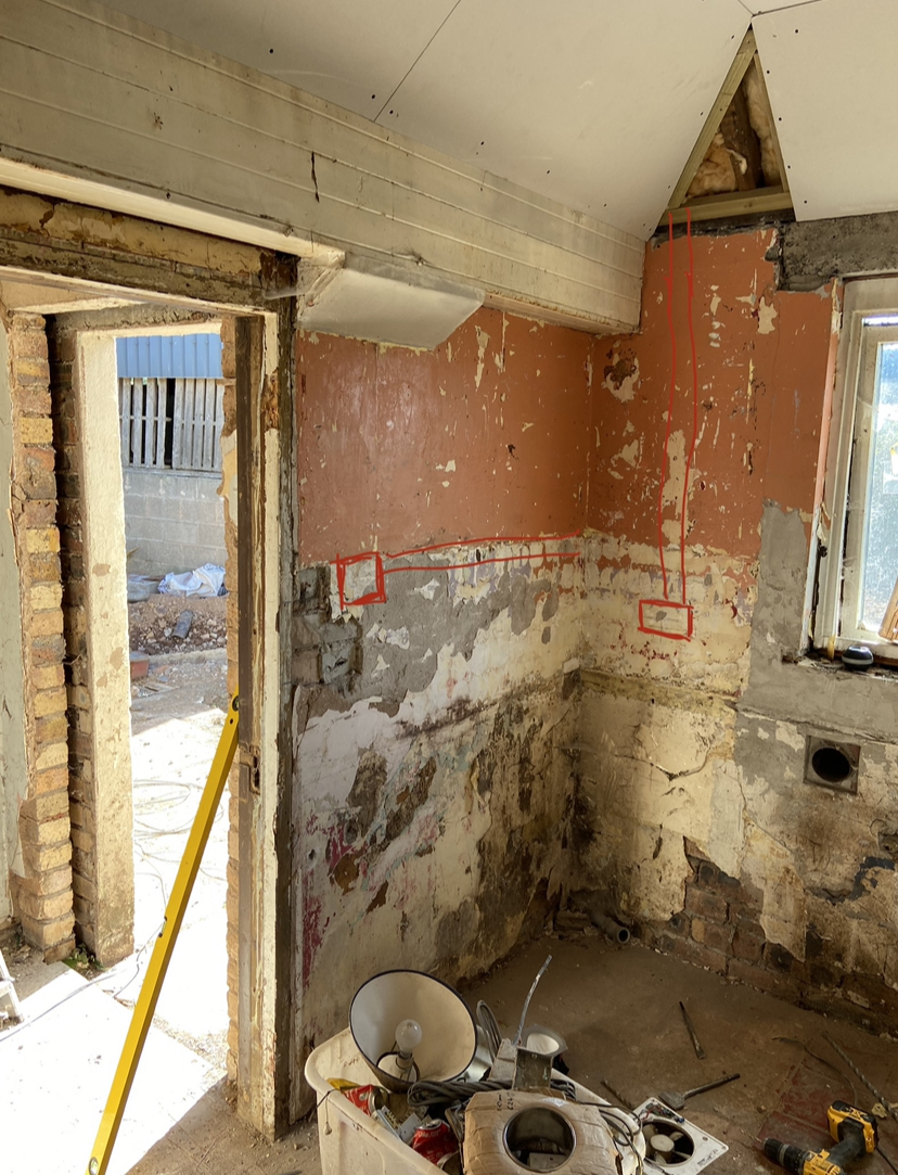

Rewiring an old farm cottage… every wall brick and previous wiring not done well at all.
I can’t locate any of the prescribed zones diagrams on the forum, and can’t always trust if I google one…. And simply can’t be arsed to look for my book.
Kitchen switch can’t go straight up, as there a concrete support for some reason above, wider than the wall…. and the old route went through the wall, and followed the door frame.
Can I go chase horizontally from switch, around the corner, and meet up with a vertical chase which will be about 400mm from corner.

Here's a pocket guide. I think you can do what I think it is you're trying to achieve. I think...
Edit: actually no I don't think you can. Because on the adjacent wall you'd have a short horizontal chase that is not in a zone. Zones cannot be continued around a corner.
  • Pocket-Guide-6 cable zones.pdf
From memory corner zone extends 150mm. I don't like the idea of using them, as few people would expect to find cables in a corner that weren't in line with an accessory, but regs say it's okay. Coming out 400mm from a corner would put you well outside any proscribed zone, unless something could be added on that wall.

For the horizontal chase…. I could go into the corner from the switch, then change heights in the 150mm corner zone down to the height of the socket, then horizontally across to there?
It’s a worktop height socket so only a short distance to change height.
Miles better than the existing cooker cable which runs diagonally for a bit.

Once the cable turns the corner, can it not go vertically up in the zone within 150mm of the corner? Or is the concrete support above to wide to allow this?

Attached picture.
Switch next to door, across to double socket on other wall.
Door leads to back hall, back door, boiler cupboard and bathroom…. Which is an add on to the square original build. Would have been an outside loo at some time.
The concrete extends beyond the wall on the other side… which was how the switch cable was routed before… clipped just under plaster surface following the corners of the wall, concrete and doorframe.

Why don't you lower the switch to the socket height?
Or change both to meet in the middle?
That thought never crossed my mind. 🤨
I was just keeping height the same where I could use existing box chases… but I don’t think anyone would notice one lower switch to be honest.
