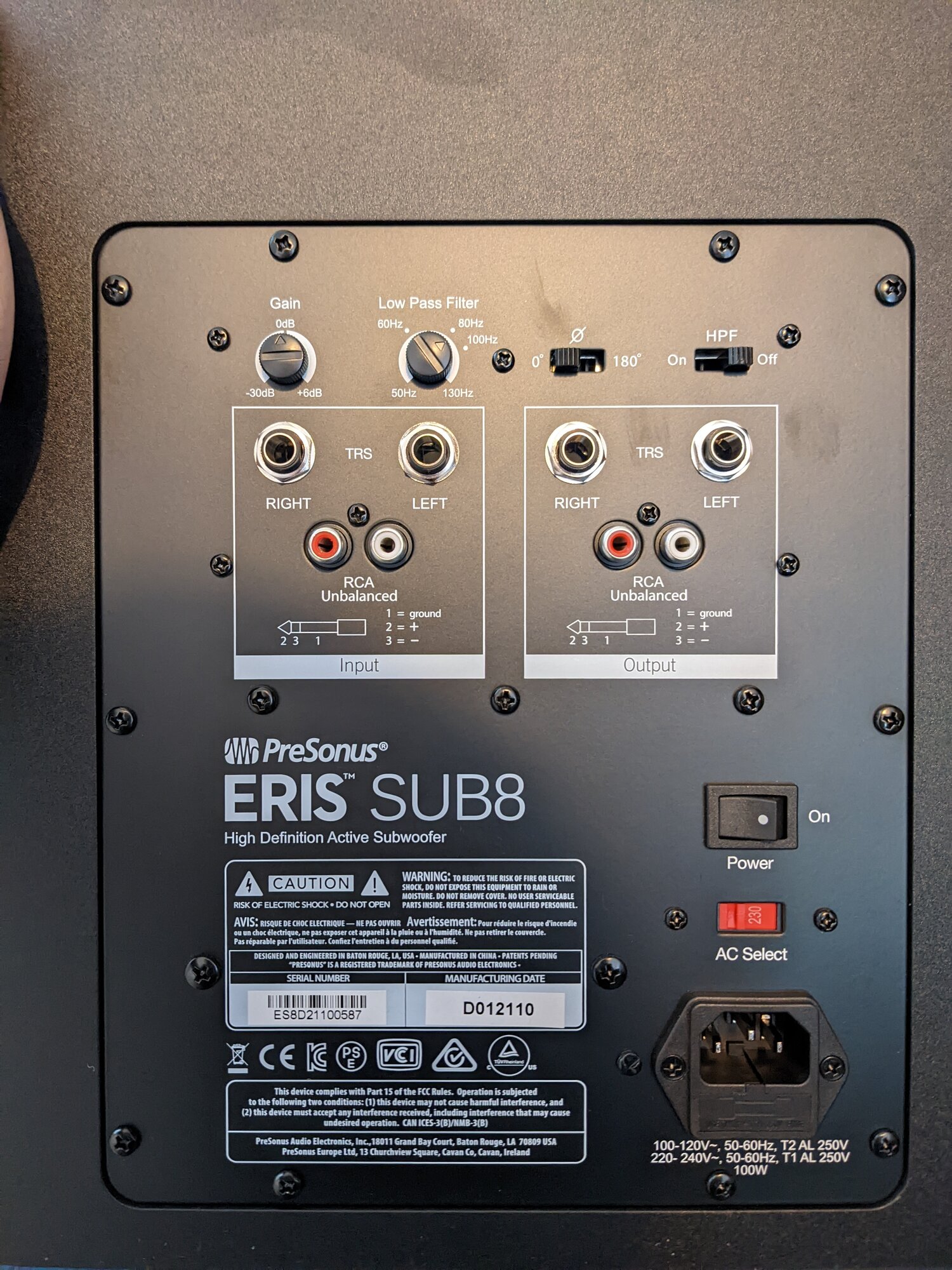

Hi folks, new member here. I am a DJ/electronic music producer with basically zero experience in advanced electronics.
I recently bought the Presonus Eris Sub8 subwoofer, I need help using this safely at home.

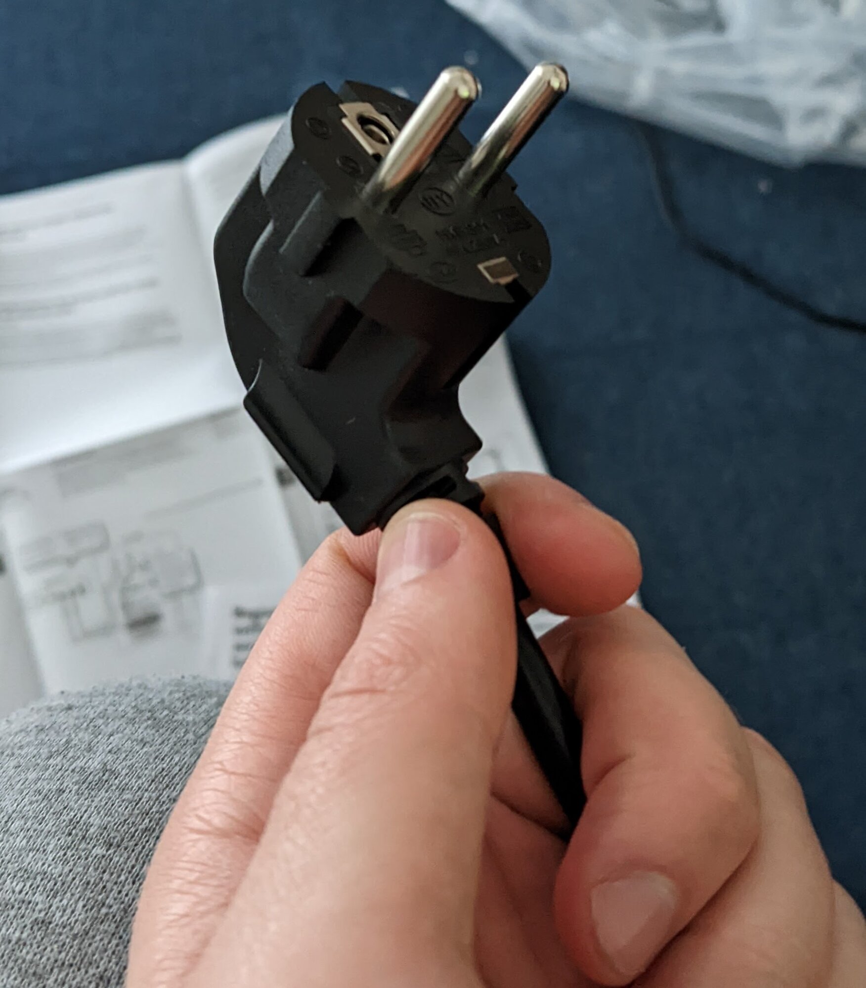

The appliance came with an EU plug (two circular rods) and it says 16A 250V on it, which I believe means it runs on 4000 watts.
I bought a cheap consumer EU-to-UK adapter but turns out the adapter only allows 13A, which from what I've read online I believe would burn/explode/start a fire if I used with the 16A subwoofer...

Update - interestingly the three-pin end of the cable which goes into the subwoofer says 10A 250V on it. Does this imply I could buy a new UK power cable that goes from 10A to 13A (rather than 10 to 16)?

16A 250V is the absolute maximum current and voltage that the plug is designed for.
From the rating plate in the pic, your amp requires 220 to 240 volts, and consumes 100W of power. Using Watts Law, this gives a current of 100/230 = somewhat less than half an amp.
