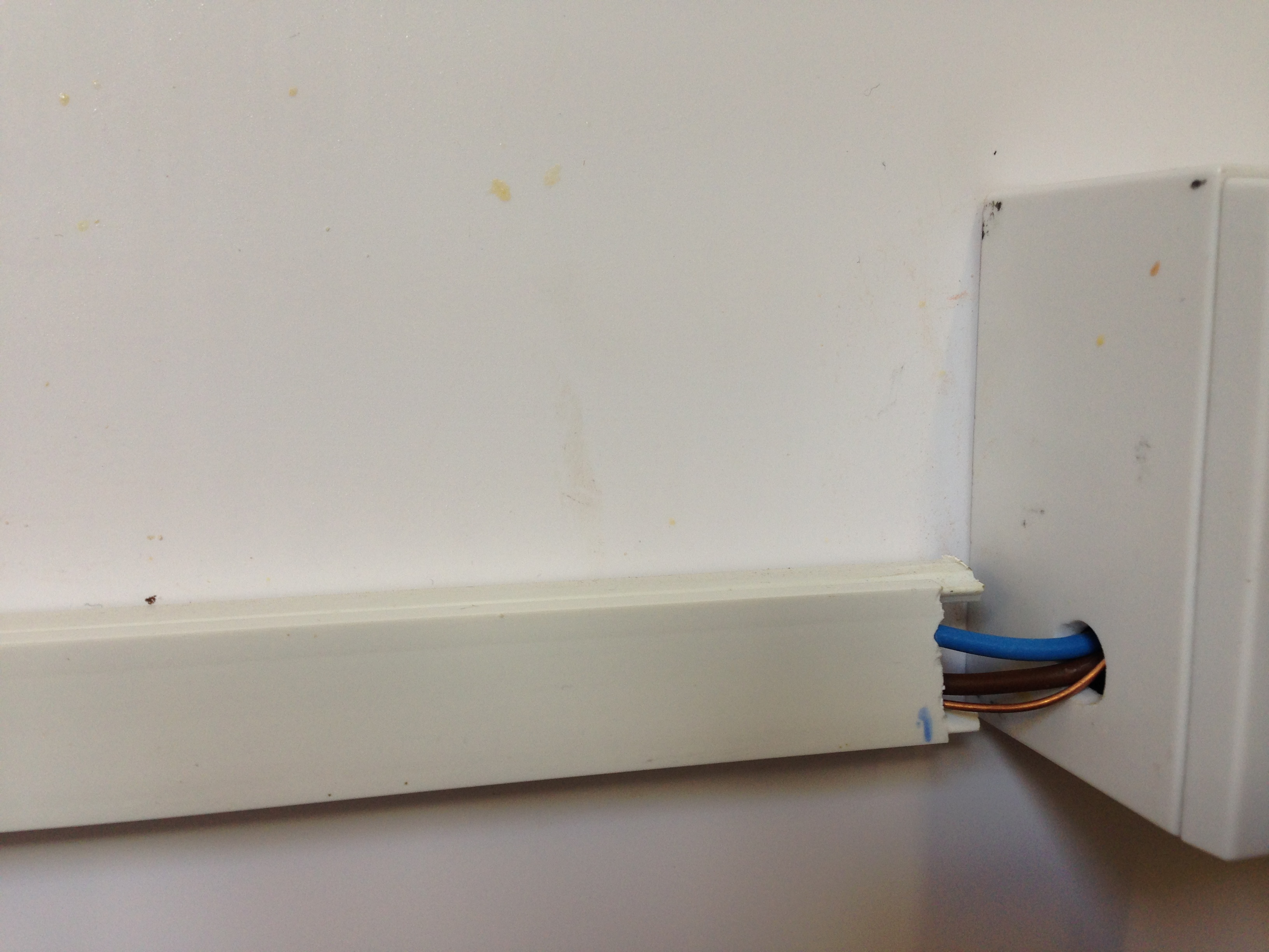

Hi all,
Was just looking for some best practices around using plastic mini trunking.
How do you guys join trunking on corners of walls that are not right angles so you can't use the normal pre made bends. I mean I've got a vertical wall and that has got a bend of about 30 degrees in in.
Every time I cut the bloody stuff I end up with a slight gap in the trunking which does not look great tbh. I was thinking of just using caulk or silicone filler but am seeing if there any tricks of the trade?

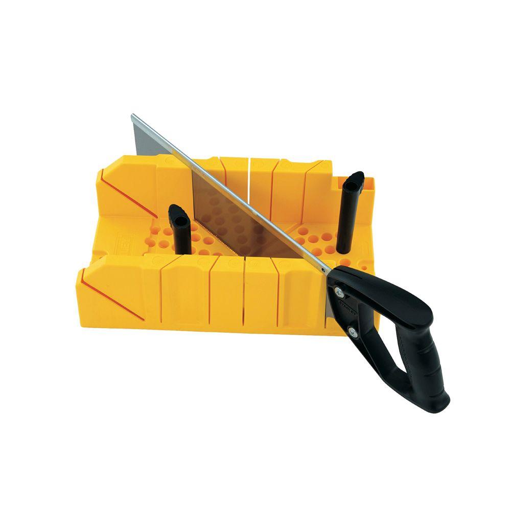

Get one of these
years of practice would help.

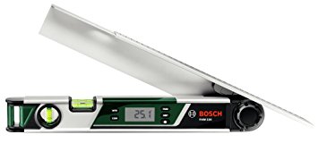

I use a small mitre saw and angle guide, along the lines of the one in image below but about half that size, it was designed for picture frame making, for angles i use a measuring device. its all about the angles!! i am a bit of a maths geek so enjoy all the planning and prep before hand :)
