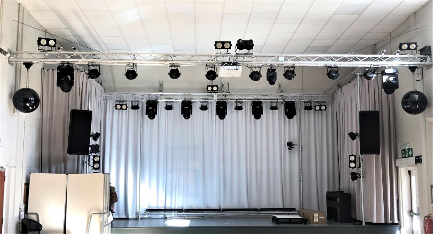

I've been volunteering at my local village hall, installing audio and light systems. Converting what was originally an underused sports hall into a venue for bands and theatrical events.
As with most of my projects, it has got out of hand and I've now reached a load schedule of 56A for my lighting rig alone, nearly all of which is LED.
Of course there's diversity: never will all fixtures be at 100% intensity together, but adding the legacy overhead of about 50A (hand driers, kitchen kit, kettles, portable heaters) I worry that I may potentially be stressing the supply. It's only a mickey-mouse domestic single phase cutout, probably containing an 80A fuse.
In others' experience, how likely is LED inrush to blow the cutout? It would be unfortunate if a widespread strobe or flash lighting cue closed everything down by killing the building's power!
Of course careful programming can keep the load down, but it may not always be me on the Avolites desk. If we have some old-skool techno operator who goes bananas, there may be a problem. :cool:
I have wired everything on a new three-phase submain DB (with L1+L2+L3 temporarily commoned), and asked the committee to upgrade to 3 x 100A, but it will take years to get agreement, if ever.

The fusing characteristics of the main fuse means a huge surge is needed for it to blow instantaneously, and a higher sustained current than the rating of the fuse to blow it later. You'll get 100A forever from a 80A fused supply (well, until something else gives up or catches fire!). And just to take a figure at random from the graph, 300A for not more that 10 seconds.
Not that I'm recommending that!
But hopefully the equipment you have, and that brought by artists, will average out to the extent of not being a problem. As has been said, logging what's happening would probably give some peace of mind. Even a cheap clamp ammeter from Screwfix has a peak current display feature (except the instrument switches itself off after a while!), so you could keep an eye on what's happening, if you aren't already!

You'll only see a surge when you lamp on (old terminology!) and experience tells me that your LX load won't be anywhere near your calculation in practice. Easy way to check (as suggested above) is just to use a clamp meter - set all the movers to white and on a pan/tilt move chase and see what you're drawing. Assuming that the moles and strobes are also LED then you'll be fine.
However - personally I'd be more concerned about how much earth leakage all those cheap fixture are dropping and how you've managed that cascade over the correct A type RCD's.
ps.... Who's that rig been designed for? A resident Abba tribute??!
