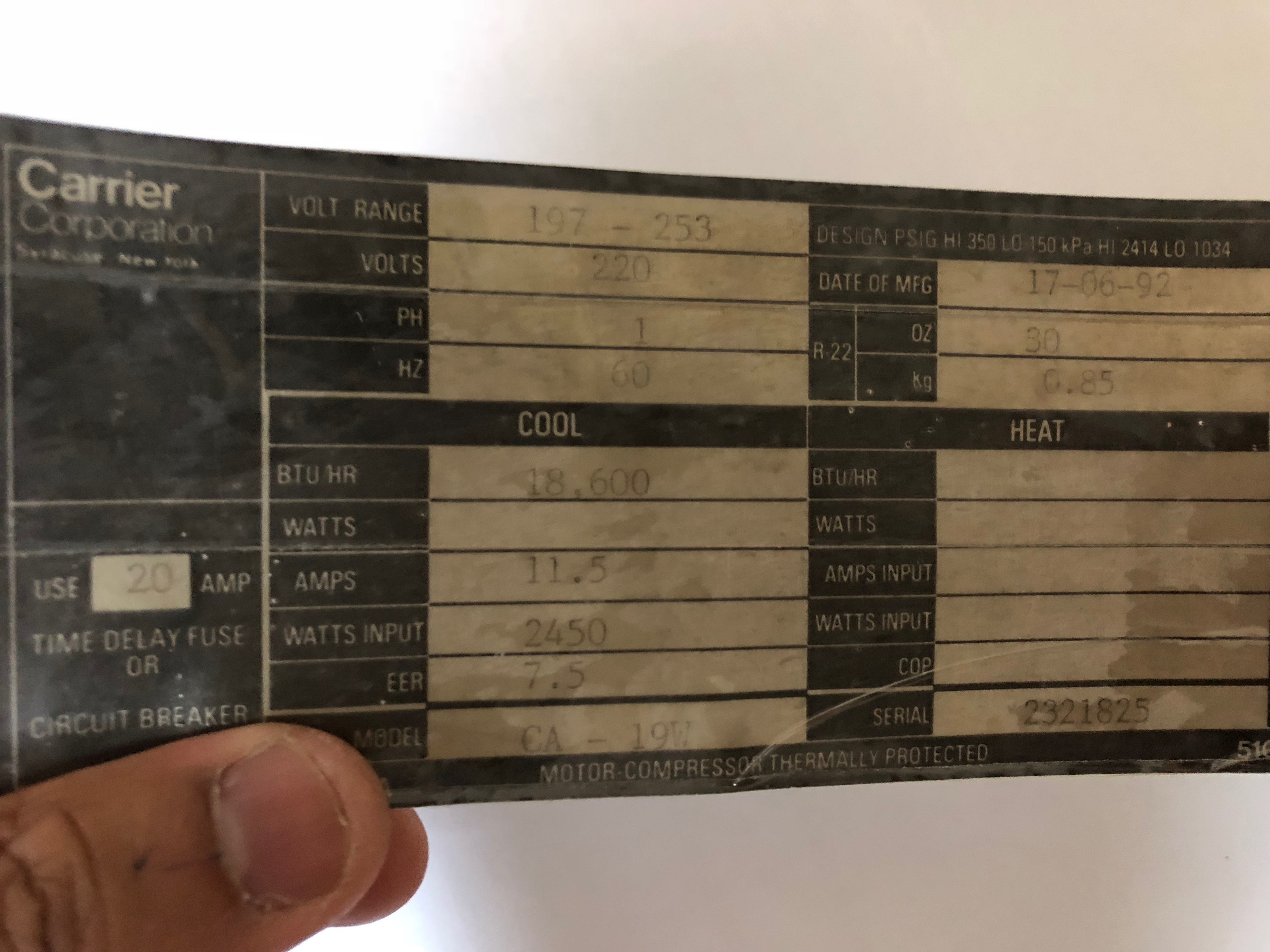

I recently got a 26 year old hermetic A/C compressor. I plan to use this as a vacuum pump mostly for some of my hobby projects after adding an air filter and a moisture removal setup to it.
The specs on the label on the A/C said that it power draw is 2450 Watts, 11.5Amps.
Does it mean that the current draw is 11.5 Amps always or is it only while there is some load on the compressor like while it is compressing some refrigerant or gas? Also I noticed that the compressor isn't very loud while its outside compared to when it was inside the A/C it was quite loud.

Sorry for making it confusing. I meant that while the compressor was part of the a/c running with freon it was loud like how a 1.5 ton a/c is usually. But once I removed the compressor out of the a/c after the freon was removed and connect to the power outlet it was only as loud as a toy motor.

The current stated on the info plate is the maximum running current the compressor can endure. In a refrigeration/air con system the running current varies quite considerably depending on the head pressure / ambient air temperature and how clean the condensor is etc. Usually the actual running current would be less or much less than the figure stated.
