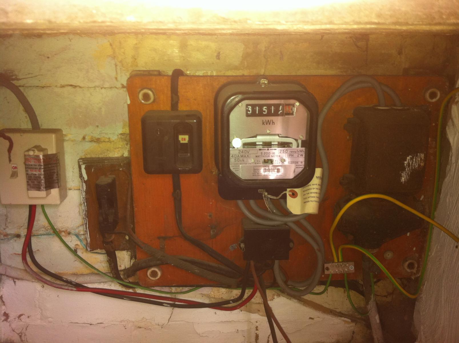

How old does a cutout need to be to get the DNO to replace? Midlands (ex central networks)
I have a old metal box (see pic) that I would like to get replaced?
  • [ElectriciansForums.net] How old does a cutout need to be to get the DNO to replace?
runs to yet another switchfuse on right hand wall. There is no consumer unit, just a collection of various switchfuses around the place. Whole thing is being stripped out, and started again.
Looking to get DNO to replace cutout (and drop in an isolator at the same time), or if the will not replace then no doubt they will charge me for an isolator!
Not sure if the cutout was originally green (or brown as is now the case)[ElectriciansForums.net] How old does a cutout need to be to get the DNO to replace?
100A DP Isolator new tails on there side and digi meter is ÂŁ39 with british gas wether you have 1 or all 3 donethe meter only gets replaced if old 1 about 10yrs old its at there discretion dont know about other suppliers But to get the dno out to replace cutout may be dearer or they may replace if its beyond its working life

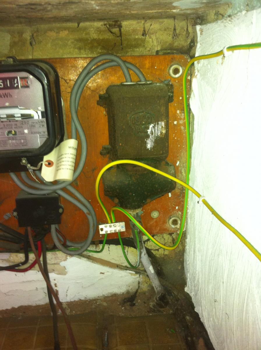

Western power AKA Eon, in birmingham, TNS, old cable head, open top funnel type tared in, with separate inline fuse. tar showing signs of age and cracked, funnel body cast and old, tails were VIR. ZE of 151ohms
Called them, they came out within the hour, slaged me to the ground to the customer called me lazy and a rougue and told them that i was wasting their time and the customers time and that i should have TT the installation instead of calling them (which i did).
Not impressed if im honnest
Look's like that will be a 30A rewireable inside the head, I've seen heads similar to that with rewireable's in. In my area EDF fitted an Isolator for free but wanted money to upgrade the head. Thad head need's upgrading, you will probably blow it if you had an electric shower and hob on at the same time.
unless you have a direct fault with the cut out mate they will not change it for free, there has to be a risk of fire or shock for it to be replaced under the asset replacement scheme, as for an isolator these are also charged for and most times requested that the sparky installs it before hand. Hope this helps
just recently had similar situation. metal clad rewirable fused live and neutral head. nottinghamshire.
phoned dno, 1 person said no problems, next had a fit and said they were dangerous and needed replacing immediately,
1 chap turned up and doubled fuse wire in neutral and called another gang to do an immediate swap who turned up and said it wasnt their problem.
eventually, third bunch turned up, dug up pavement, changed head and cable charged customer ÂŁ50 back-hand and buggered off.
