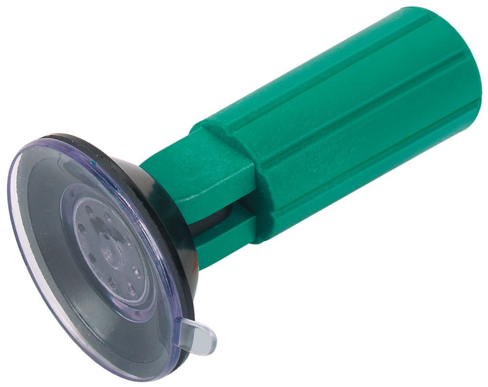

That looks as if it could be a GU10 led bulb Inside.
Is the aperture in the front plate big enough for the bulb to go through?
If so, could you just use one of these?
Thanks for the reply! Unfortunately the aperture is completely sealed by glass - so the bulb isn’t accessible at all.
I'd have thought the Bezel should screw off with a quarter turn or similar, if this is just one light if it's not coming off you may have to replace. If there's another see if that has more play in the feed to it or try to see if the bezel comes of easier that the one you're currently trying to replace the lamp in?
We had these types in our house when it was new 16 years ago.
I think the heat of the halogen bulb made the thread difficult to screw off. Ours was a porcelain bezel, and metal fitting,
Even taking the fitting down out the ceiling and attacking it with plumbers grips wouldn't slacken it off.
Both have now been replaced with LED fittings, but needed to get an adaptor ring as the existing hole was too big.
