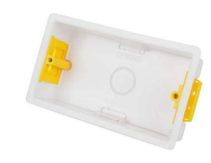

I'm trying to understand how to fit a metallic back box on a stud wall. Should it be fixed to a stud (on one of the sides) or is it expected to be fixed to a noggin?
In either case, how would I know exactly where a noggin or a stud is, so that the hole I cut on the plasterboard is perfectly aligned with it?
I have a stud detector, but there is always a degree of error, so I'm not sure how I can find these in the wall. I wanted to avoid using the plastic back box that clips on the sides.

Why a metal backbox? Why not fit something like this.

Either fit above or timber ground to secure metal box to. Either is fine. Sockets and switches will generally all be around the same height according to regulations or just take measurements before boarding.

If you want to know where studs are, get hold of a strong magnet, it will 'find' the dry wall screws. Google "studfinder magnet". Well worth having one.
Good quality dry wall boxes e.g. Appleby are also absolutely fine.
Dry lining back boxes are designed exactly for this and are quick and easy to fit. I have fitted thousands of these and never seen one pull out in single or double boarded plasterboard
If the walls are finished you really don't have much choice of fitting a metal box easily
If the stud walls are not finished or only 1 side is boarded then you can use the extendable brackets for fitting between studs
Britclips extendable bracket
You've lived quite a sheltered life if you haven't seen a plasterboard box ripped out of the wall with lumps of plasterboard still attached to it!
I'm sure I've seen it a dozen times over by now.
It's very easy to fit a metal box in a finsihed plasterbord wall, just use a metal plasterboard box!
