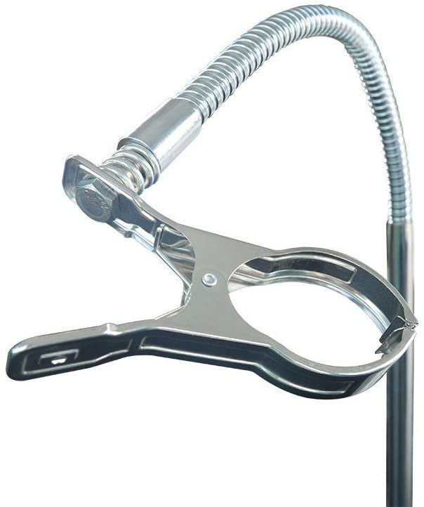

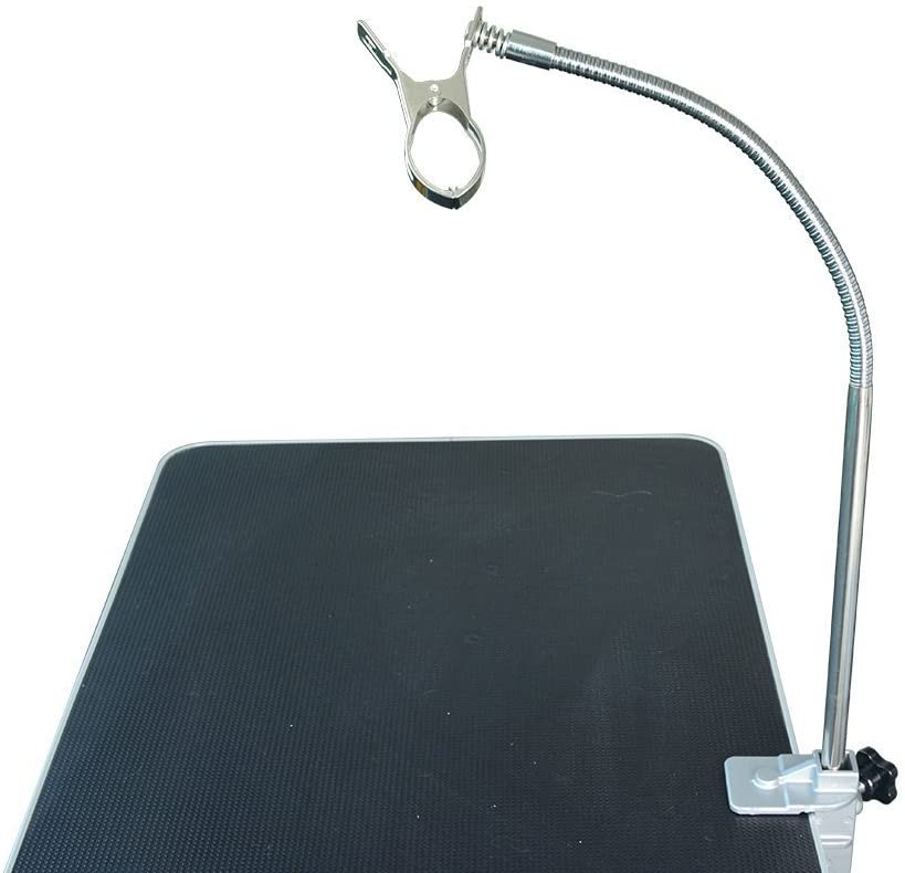

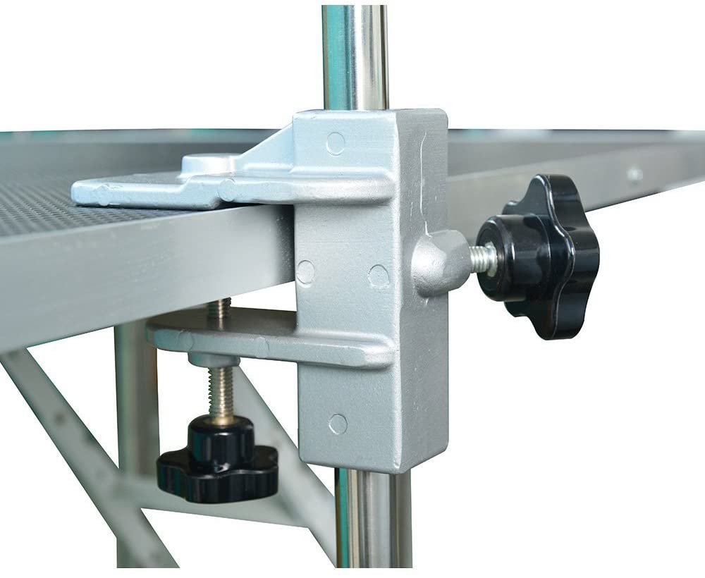

I do sometimes latch the ladders down to an eyebolt or at least to something solid even if it's just a rigid soil pipe. Still doesn't solve the one handed issue though. I had a nightmare putting a cctv camera up other week when I had to get three small screws into the roof overhang while holding the camera. I managed eventually but I wouldn't call it safe working 🤨
I was looking at one of the below (meant for holding a dog grooming hair dryer lol).
Worth a go?

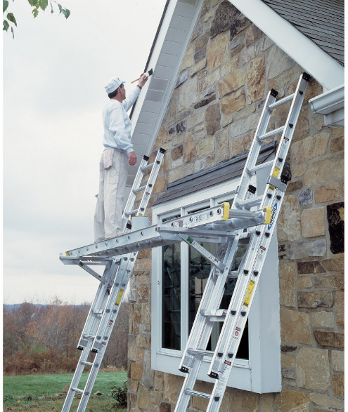

I think this is the model we have, not too heavy and non-conductive:
Here is UK site, not cheap at around £200 inc VAT, but has lasted well:
They look fine pc but I don't think they'll rech the eaves. Not unless you balance several of them pyramid style
