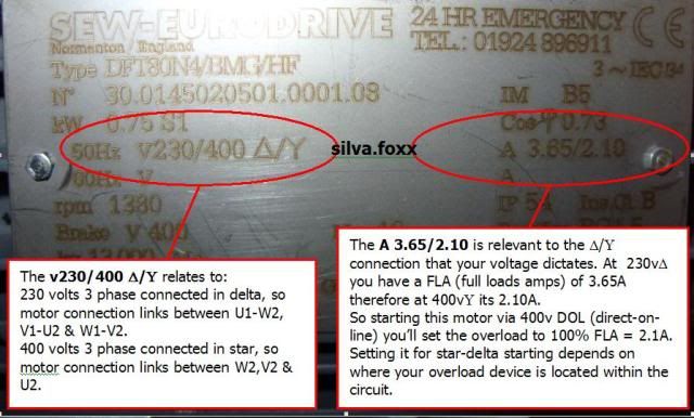

Check the rating plate. It will give the voltage and connections, some will give two voltages.
400V Star
220V Delta
If it shows 400V Delta them it is suitable for star / delta starting.

As with everything within industrial electrics, wire as per manuf. instructions. In this instance the motor plate tells you almost everything you need to know. You need to know what supply characteristics you're applying to the motor you have. If you have a 3 phase 400Vac supply and a DOL starter then the plate tells you to connect it with respect to the ratings.
[ElectriciansForums.net] How to know whether to wire as star or delta?
also come across 400/660V or maybe 415/690V or something similar a few times (the most recent 2 week ago), you wanna connect that as per Delta when using a 400V supply.

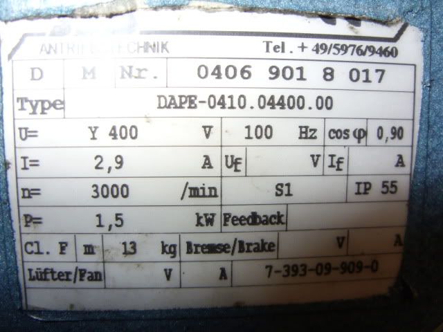

12-18 months ago I carried out a maintenance check on a bottle inspection machine and declared a motor, in a wet area, needed monitoring due to low(ish) IR reading. This is the original's plate.
It caused a little confusion. The hierarchy decided to get in a 3000rpm 50hz model and have it fitted to allow the original to go for overhaul. The machine would not run correctly due to obvious speed differences!
