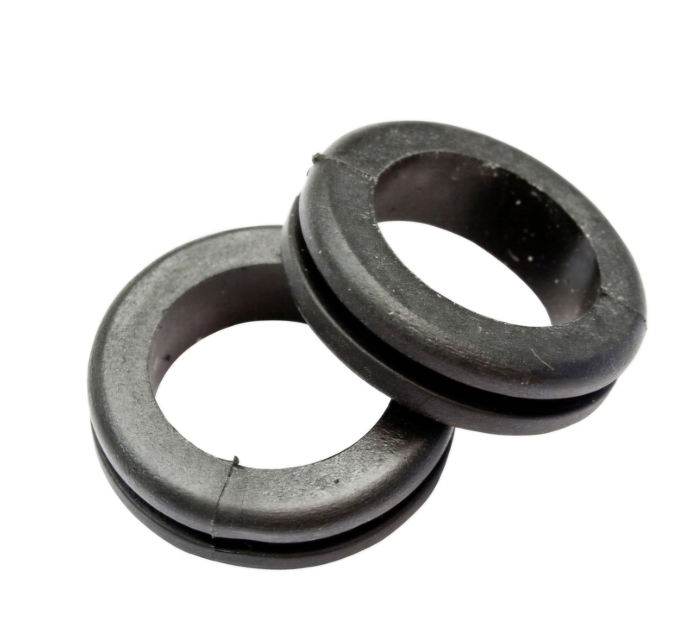

I bought this junction box from screwfix. I need it to put my cctv camera connections in there.
Outside near the camera. So a camera cable will come into it and one cable that is for power and DVR which goes to the room its in. So I need 2 holes .
Do I pull them things out that are in rhe holes? Or drill in them? Do I just feed the wire in them. Or do I need a special gromit etc ? I am not using any conduit etc. Also shall I feed the cables in the horizontal holes to avoid raining getting in from the topnotch the box?

You would be better off using something like this and using suitable compression glands for the cable.
The junction box you have is not really suitable if open to the weather.
And yes cable entry from below if possible.
The holes in the first box, if you take the plastic gromits out, are slightly bigger than the standard 20mm.
The gromits can be slit with a knife, or drilled out…. Or not used at all and the holes filled with sealant.
It’s only for CCTV, so not mains voltage, but water ingress can still be a problem… as can spiders and such setting up home inside the box.
CCTV also suggests the cables you are running will have fixed plugs on the end… compression glands may not close up enough to seal around such small cable size.

If the seals in this box are of the thin, flexible type, then I know from experience that the unused ones will fail in time if exposed to sunlight.
Those boxes are total carp and will deteriorate when outside, but there again what do you expect for £1.50.
Regrettably, you get what you pay for… so first link, the cheaper one, is only IP54…. So not completely weatherproof… but maybe ok under a soffit, or somewhere sheltered.
There is a customers image on the page showing it being used with CCTV cabling.
the other issue is the lid simply clips on. If it’s not screwed flush to the wall, and the plastic bends out of shape, the lid won’t stay on.
I installed an outdoor CCTV camera recently. Not possible to lead the cables into the rear of the mounting plate. I mounted the camera on the lid of this:
It worked perfectly. The box is sturdy, comes with a few wagos and mounting rail but I didnt need those. The cable needs a proper waterproof gland, not the stuff that comes with the box, but a standard Tower or similar 20mm gland works well and will clamp down on the small cable.
Basically, I put a 20mm hole in the middle of the lid to pass the cables from the camera through then bolted the camera mounting plate onto the lid, with camera attached. The camera has power and ethernet cables but I didn't need the latter. Thus, the A box has plenty of space for the cable and connectors and gives flexibility as to where to position the camera.
Power cable is bottom entry via the weatherproof gland and a drip loop.

I agree with the other posters, it's not a great product BUT but to add if you must use that box ALL cables should enter and exit from underneath with a loop down on the cables so that water moving along the cable can't find it's way in, and the fixing to the wall should have sealant on the screw holes. You might be in with a chance if you do that.
