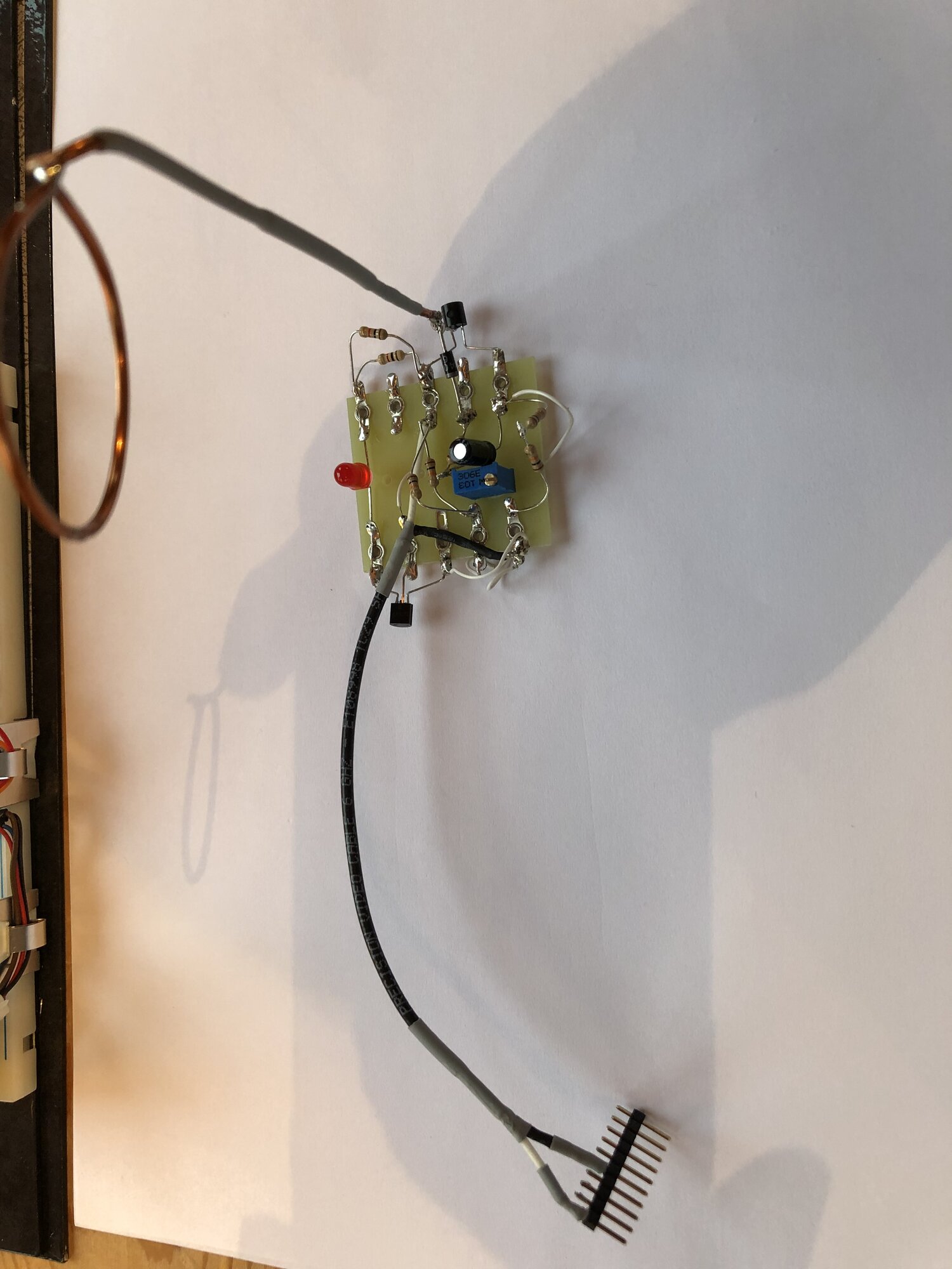

A couple of attachments to show my SCM as constructed.

And here are my morning’s thoughts on the electrical situation of your circuit boards ( the red line) and of the antenna. These are working scribbles which I hope will make sense to you.
You will see I hope that the ac potential Vb of the wings circuitry ( all modules) and the antenna with respect to earth/ground is highly indeterminate because of the variation of the couplings to 220V and to earth as I have attempted to illustrate.
Even when you place your hand near the circuitry or the antenna the potential of your hand is highly variable.
This goes someway to explain why the location of the board on the bench or wall makes a difference and also how the wire to the lamp relay from the RDM2 will change coupling and hence the potential Vb of the circuits or antenna. It is unsurprising that the performance of the rudimentary SCM circuit is badly affected since it is so sensitive.
I will address the question of what to do about this next after some more thought.
