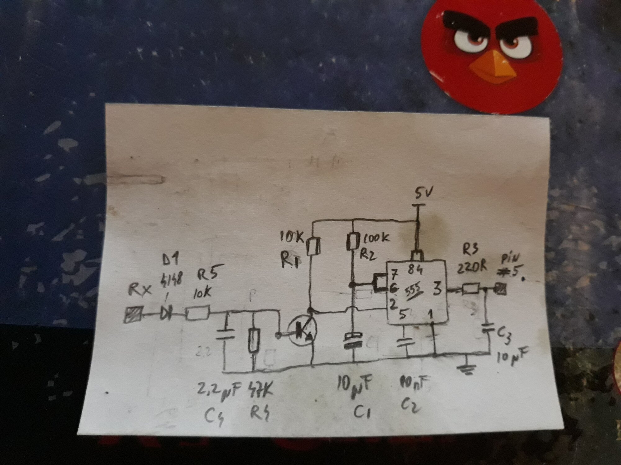

I have a electronic board with leds (made by me) that is driving a relay. When that relay is closing it’s contacts, is actually switching the 240V for the light bulb switch in my room. This board is quite long, like 50cm (half a meter). The relay is in the left corner, and the live wires from it goes in behind the board to the hole in the wall for the mains switch. I also have a mild steel sheet behind my board that is grounded. It is shielding the interference of the 50Hz from the live wires from the wall to my sensitive circuit. But even If I have this grounded metal shield behind my board, the live wires from the relay are still affecting my entire circuit board, keeping it ON all the time. If I am disconecting the live wires from the relay, the board is functioning very well. Another IF, is if I disconnect the ground from the metal shield, the circuit board goes nuts. So the shield is doing it's job fine, but only for the live wires inside the wall !!! But not for the wires from the relay to the live switch.
- I want a way to shield these wires !

In words and briefly because I ma being pestered by Maud our 9 weeks old puppy - you remember I showed you some near perfect rectangular pulses on my new scope? They were at the output of the 555 clock running at 25kHz. In the latest post, these pulses switch a MOSFET transistor on and off which in turn turns the 4 infra red LED illuminators on my sensor array on and off - equal time on to time off or a 1 to 1 duty cycle/mark-space ratio.
One might expect that the LEDs will produce perfect pulses of ir light - instantaneously on and instantaneously off. Similarly, when these pulses reflect off something in fron tof them back to the photodiodes, the current which flows in these photodiodes instantly starts to flow at a constant value (dependent on the intensity of the received ir light hitting them) and instantly stops when the light turns off.
The little video of the current waveform (actually shows a the voltage this current develops across a resistor) is not instantaneously flowing or stopping. There is a rise time and a decay time. The rise and the decay look the same shape and duration as one would expect from a 1 to 1 duty cycle. What I wanted to show is the benefit of 'seeing' the waveform actually produced by a sensor on the scope. It dispels any notion that it is a rectangular waveform exactly the same as the driving waveform derived from the 555 clock. So this is the signal which the sensor produces and it is a distorted version of the driving waveform. Why is it distorted? Because in electronics (as in many physical systems) there are lags and delays between stimulus (the driving waveform) and current response by the photodiode. No device can actually respond instantaneously - they can respond very quickly indeed but there is always some time required to respond.
The longer it takes something to respond the slower it clearly responds to changes. The predominant reason why the waveform becomes distorted is the photodiode ( and also the transistors and LEDs) have small amounts of capacitance which I hope you know by now tends to slow down a change in voltage to a change in current. Thus we speak of a CR circuit have a time constant which is related to its frequency response and so-called impulse response. For more look at:

I have not yet begun to tackle the background light problem. If I have time I will make a video of the sensor voltage waveform changing in amplitude as objects move closer or further away from the sensor.
PS: To understand electronics and thus be able to design circuits one must learn some theory. I hope you find this interesting and gives you some insight as to what is happening.

q12x Good afternoon. I spent a couple of hours on my version 3, the one which uses pulsed ir light rather than continuous illumination in versions 1 and 2. The pulsing is about 100kHz. The received waveform produced by the ir sensor array is displayed in yellow in the video clip below. The amplitude of the received waveform, which is the combined output of the four photodiodes, varies with the proximity of the hand. I cannot remember if I showed you this variation before. What I did this afternoon is construct a peak detection circuit the output of which is displayed as the blue horizontal line on my scope sitting on top of the peak amplitude of the yellow waveform. Unless my finders are in front of the array it is detecting the side of my scope. You can see the voltage output by the peak detector in Blue following the amplitude of the received Yellow waveform. It is this Blue signal which I will input to my 8 comparators. I will look at the output of the comparators only when the ir illuminators send a pulse of light in order to distinguish between this illumination and background illumination.

I thought you might like to see a little more progress albeit at a snail’s pace. You know in Version 3 I pulse the ir illuminators on and off and its is this reflected flashing light which the photodiodes receive as well as any background ir light. The photo current of these photodiodes is converted to a voltage which is passed to a peak voltage detector. I thought I would plot the peak voltage at the output of the detector against distance for ir illuminations on and off. The simple test rig is in the first image and the plot in the second. The white piece of paper in the blue clamp is my test ‘hand’ moved along the 15 inch rule towards the sensor array. The steady voltage in red for ir illuminators off is about 60mV and shows the background ir is making no difference to the peak voltage detector output as the hand is moved. You can see the On peak voltage signal is clearly separated from the ambient only off signal. With further signal processing l hope to make Version 3 tolerant to background ir illumination.

q12 A little more progress. The second attachment is a view of the breadboard for Version 3 with circuitry to produced pulsed ir illumination, reception of ir pulsed reflections, peak reflected signal detection and a to d conversion to drive the rule of 8 LEDs. You can see in the first attachment the rule of 8 LEDs lighting up as the hand is moved closer and further away from the sensor. This set up is showing permanent pulsation of the ir illumination. The next step is to have repeated bursts of ir pulsed light so that in between bursts one can detect just the ambient background ir received by sensor.

A little more explanation. Version 3 uses pulsed ir illumination. But of course as well as the pulsed ir being reflected off anything in front of the sensor array producing a received signal component Rp there will also be received a component of reflected ambient ir Ra and direct ambient ir light Da. The total received signal is therefore Tb = Rp + Ra + Da. This is what is detected during the bursts of ir illumination.
Between bursts the illumination is off so what is received is only Ra + Da = T
If then one detects, measures and stores Tb and T, then the difference can be produced Tb - T which is the signal Rp just due to ir illumination reflected off the hand.
The next step then is to measure T.
